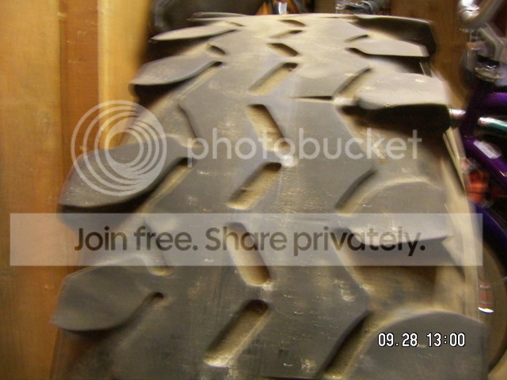

can you groove bald tires to get a little more life out of them? or is it a lost cause?
here is one of the tires in question
Try it and you should find out pretty quick if you go past the bottom of the tread and hit wire, the tire will be done and corvair safe.
What's the plan for the tires? I had one 42" bias TSL that was real bad. I grooved it to make some tread. Is it a radial? If so, you can't go much. With my bias I went almost a 1/4".

Yes, it can be done, but the question is how much rubber is still there. Some bias ply tires have multiple levels of tread and you can cut the higher stuff down to the level of the lower stuff and make more tread. On that tire, you'll just have to try and see. A real groover should let you set a standard depth. Bear in mind that even if it "has tread" after this, it will still be a smaller diameter than new tires. The mismatch can be weird if you use 4WD on roads.
they are bias ply tires. the plan is to be able to run them till i can get 2 new rear tires as the front are new

When I grooved my bias tsls I went basically to the cords. Just right above em. No leaks or issues.

True. I wasn't thinking bout how they would work off road on rocks. I want to use for some dirt racing.
We have grooved old asphalt bias slicks down to the nylon and ran them on dirt

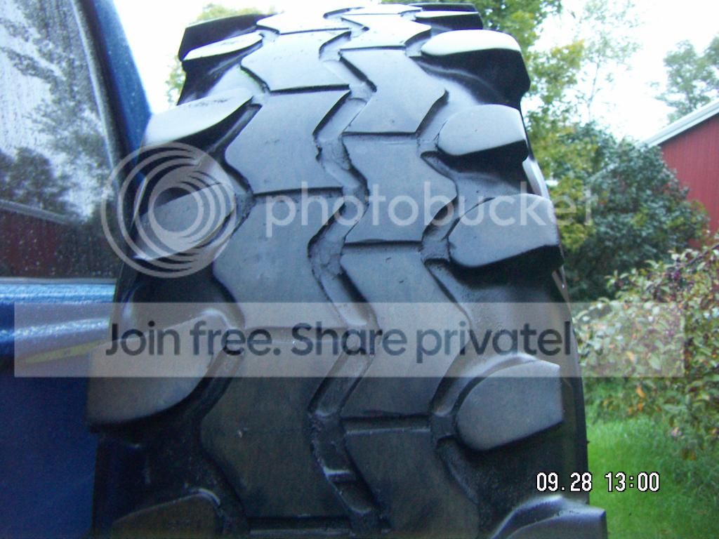

I didn't really want to admit to this, but this is a good example of what you're looking for. I'm just carrying it as a spare until I come across something better.
This is really butch. Between the blocks was done with a router and the straight lines across with a cut-off wheel. The tread pattern you have is more difficult. You may find it easier to modify the pattern as you groove, but you'll want to use a real tire groover, I think.
