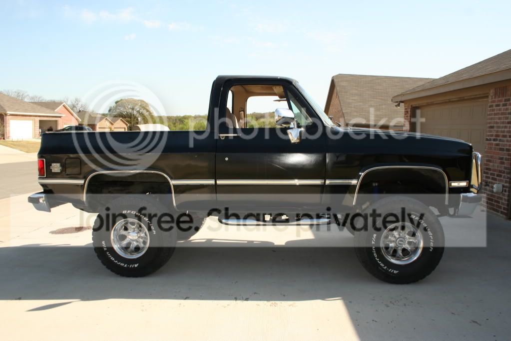

I run 35s with 4" springs and 3" body lift. I feel confident I could run 37s and be alright not cutting if I just use it to run around and not to offroad too much...
But I like the 35s cause it is in good proportion with the lift and IT STILL FITS IN THE GARAGE!!! Big plus with that one....
