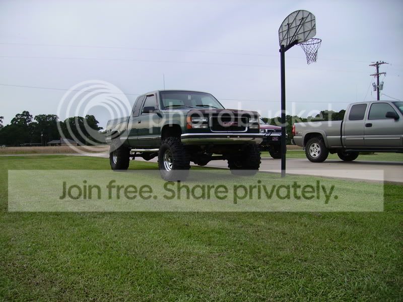

Here are some 38.5 x 16 x 16.5" tires on a standard 9.75" wide wagon wheel (~2.75" backspacing)

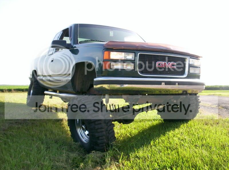

I have Parnelli dirt grips on 12 in wide Weld SS II wheels with OMF bead locks. they dont have as much tire side wall bulge as on a 9.75 wheel but they look bitchen nun the less.
