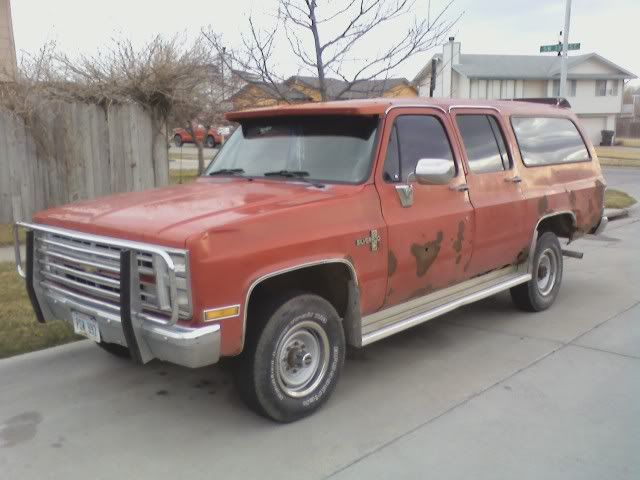

That's not completely true. It depends upon the width of the rim. I ran 16" steel wheels from a 1998 K2500 on my 1975 K20, and on my 1988 V10 (with the 1975 K20 axles). Here is a pic. The newer trucks do use more backspacing, and that is the problem the original post is experiencing.

Ah that is true. I have my snow tires on those rims (salt destroys alloy rims). I was referring to my alloy rims, which are always more prone to fitment issues.

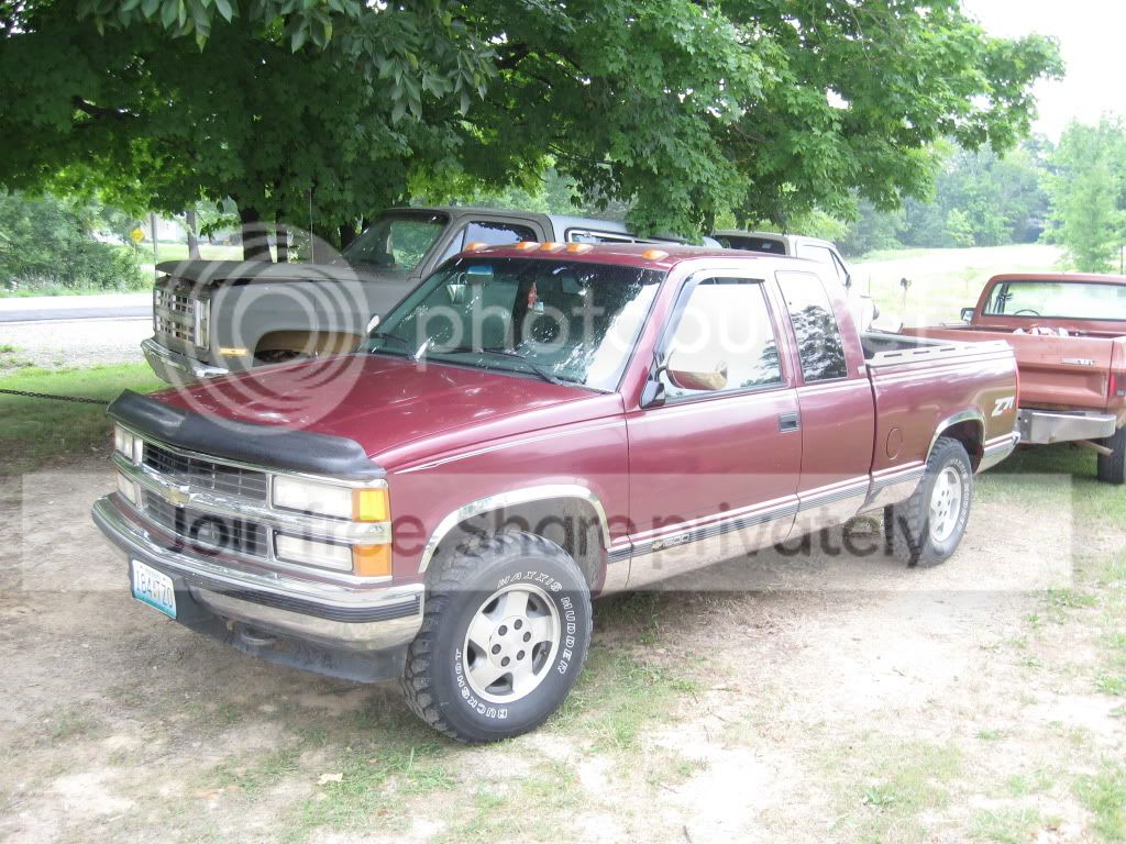

do the rims look like these?? If so backspacing is definately your problem. I hate that the older trucks tierods are so close to the wheels. I've took weights off myself this way
nah, there Mickey Thompson. just think they were bought without the proper bs. They were on the truck when I bought it.
