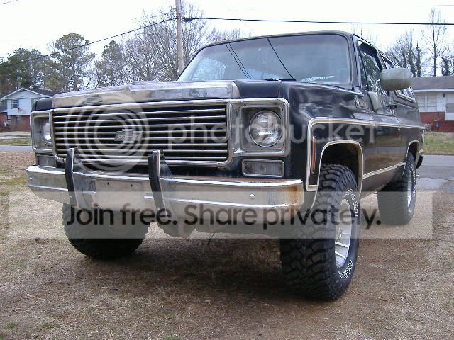

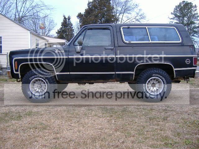

    i like my Hankook Dynapro's in a 33 12.50...they ride good, are rather quiet for an agressive mud tire and so far have worn decent(only 2 weeks old though LOL) and they were only like $144 each
    mine is bone stock with no lift at all and they seem to clear fine so far
