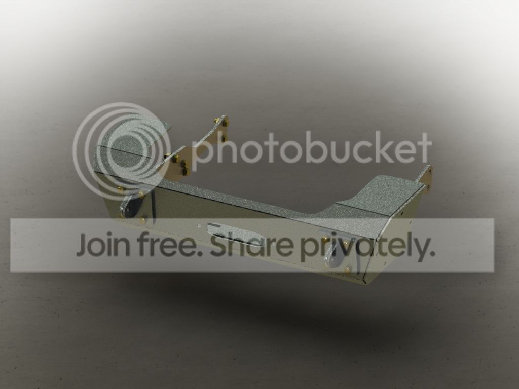

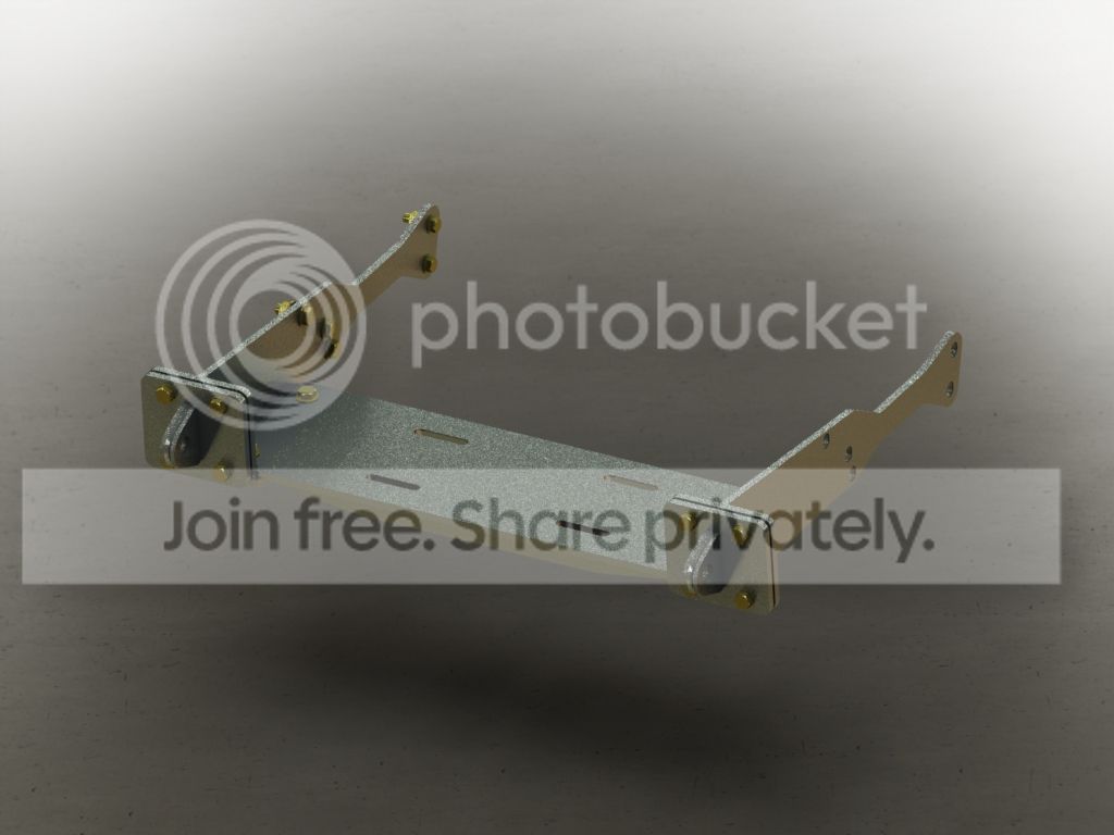

1. There is a main beefy bracket system that attaches to the front framerails via 10 bolts (6 of 1/2" bolts and 4 of 7/16" bolts) and has a winch mounting plate capable of handling up to 12,000lb winches, including the new Warn Powerplant series. It is all 3/8" plate (other than two 1/4" gussets) and extremely heavy duty. At the front there are two plates with 1/2" nuts welded on the back and two plates with D-shackle tabs that bolt on to those, and together they "sandwich" the bumper center shell: (CAD rendering)

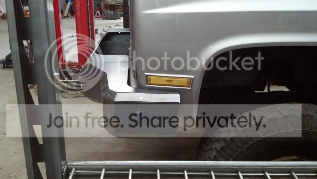

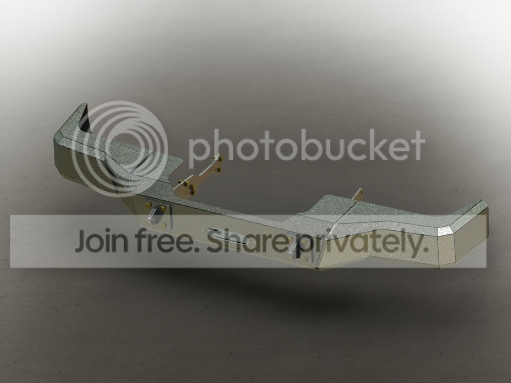

2. The "Center Shell" is fabricated from 3/16" and 1/4" plate and has large holes where it bolts on to the main bracket system, therefore allowing quite a bit of side-to-side and up-and-down movement to get it aligned properly to the body. It looks something like this when mounted to the main brackets:

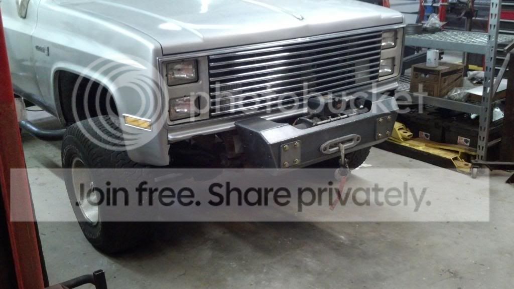

3. Then there are the "Side Shells" that bolt on to the center section to make a complete bumper. They are also 3/16" and 1/4" plate. They wrap around the factory fenders, but don't go all the way to the edge of the wheelwell opening. This is in case you have trimmed your wheelwells for tire clearance. They do, however come close enough that if you aren't trimmed, it still looks decent:

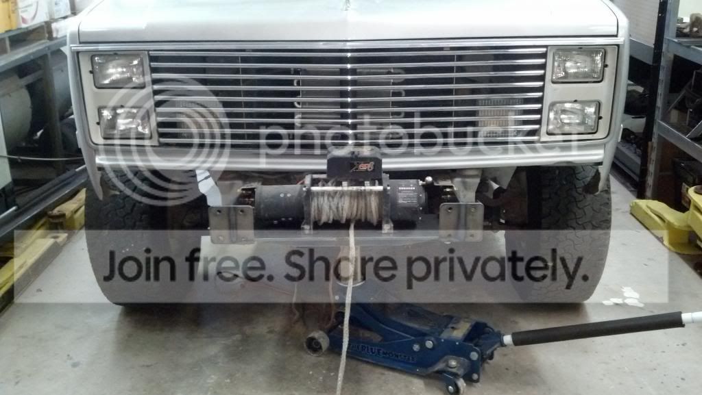

1. The Mounting Bracketry with a Smittybilt 8k winch for mock-up purposes:
2. The Center Section Shell installed:
3. With the sides installed (not fully welded yet, just tacked together):

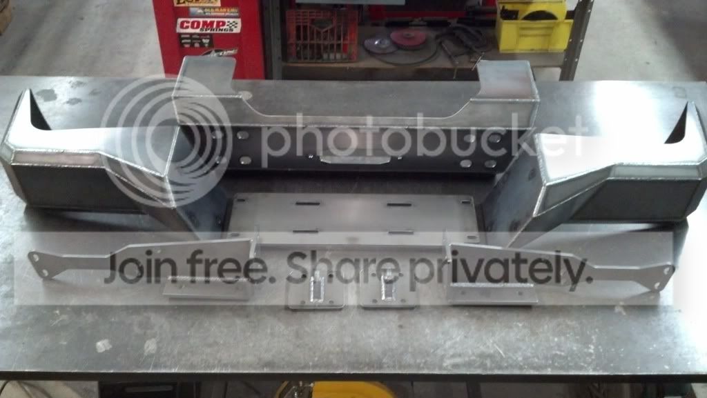

A complete bumper ready for shipping (minus the hardware that goes with it):
