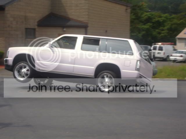

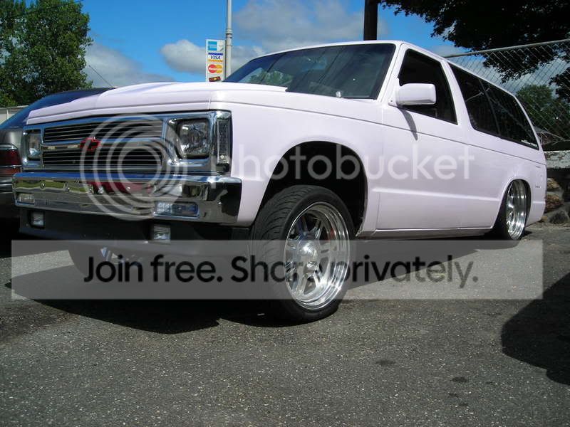

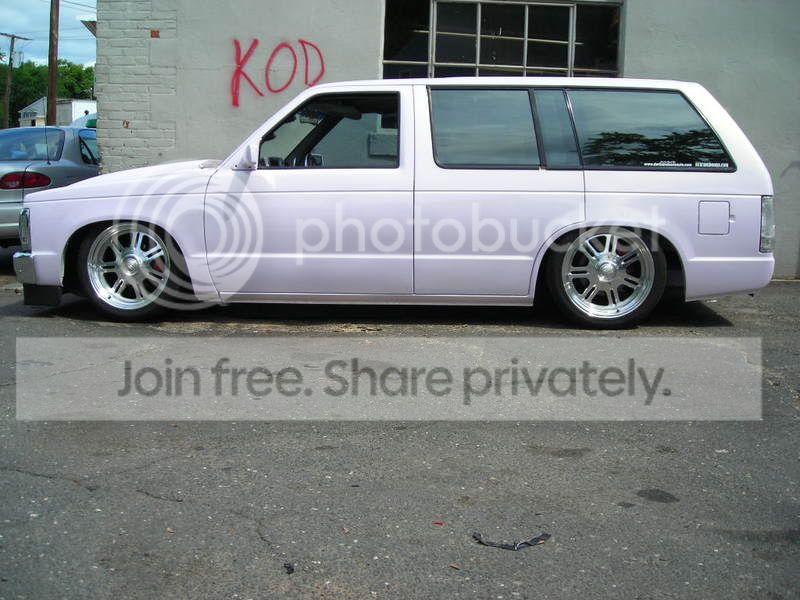

my 92 s-10 is set up with 2 valves for each corner. this way i can control each on there own.
to get an idea. here it is layed out.
here it is front aired up. ill have to find a picture with all 4 aired up.
