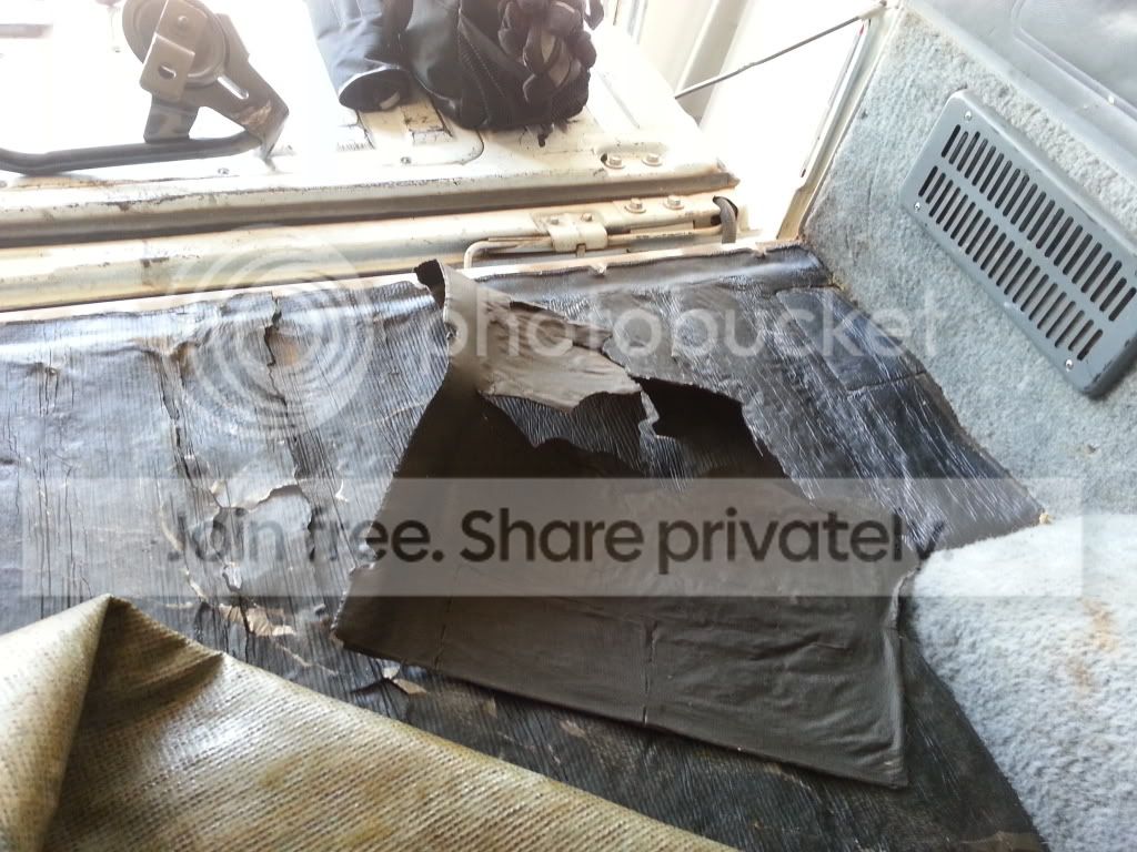

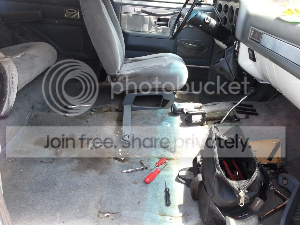

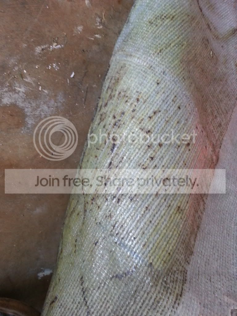

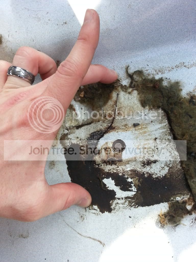

Well I did some work on the truck yesterday. Stripped out almost the whole cab to check mounting bolts for cracks. I found a crack on the passenger rear seat mount bolt. So after I get that welded and have the other mounts reinforced I was debating on weather or not I should bedline the truck. The carpet looks ok. can't tell if it's mold on the bottom or what. the pad looks ok too. However, the plastic noise damper is majority dry rotted.
I like the convenience of herculiner, but I think al's liner may be a better lasting product. Can I re-roll on herculiner in a few years? Or do I have to totally strip it?

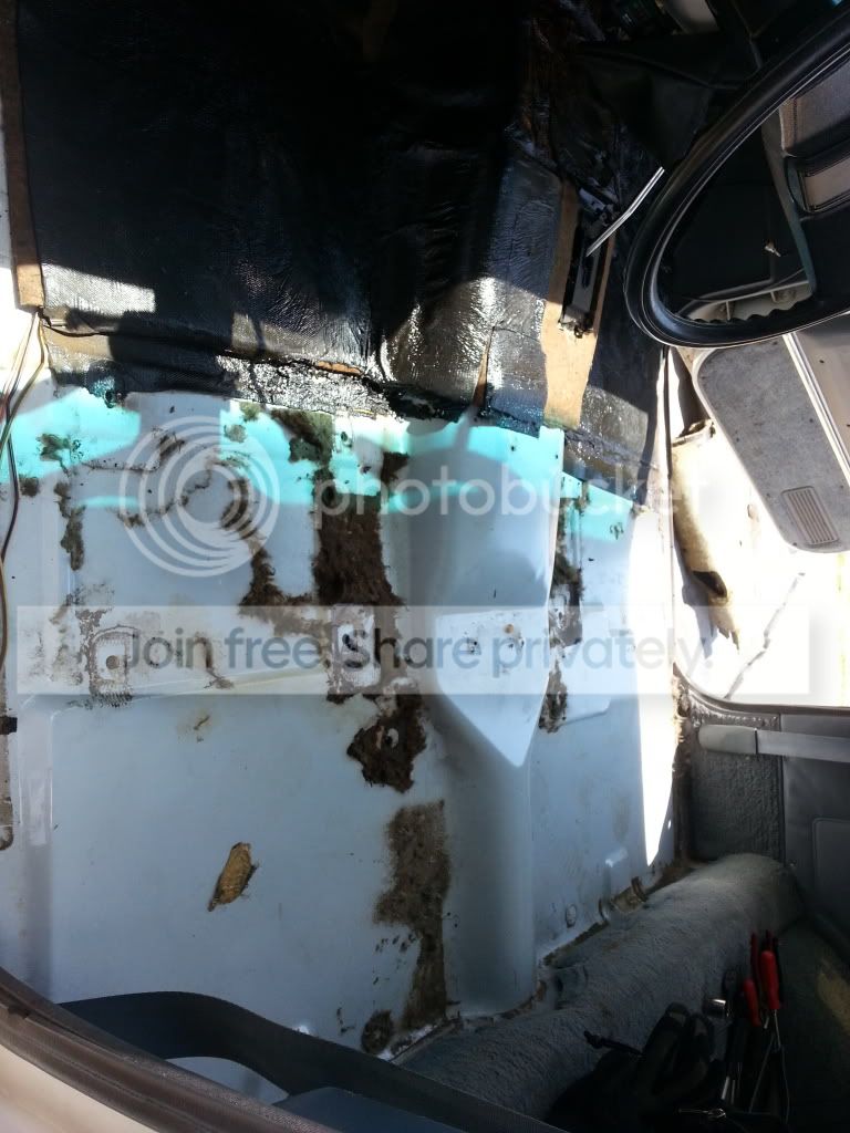

How do I clean all the insulation and crap off my floor with out destroying the paint?

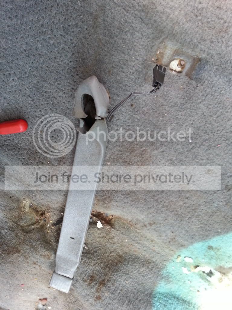

Also what is this wire for going to the drivers seat belt?
I don't have any secrets for stripping the floor.
The wire is probably for a seat belt sensor so Big Brother can make sure you're buckling up. But mine is an 88 and I don't think I have one.
If you're considering DIY bedlining the floor, I would just scrub the floor w/ a red scotch-brite. This would clean the insulation off the floor and also prep it for the bedliner. You can still put carpet back over it. I did this just because I liked the rust protection and sound/heat barrier that a little bedliner coat provided. I also don't see any reason why you just can't roll over it again in the future. Bedliner should be able to stick to itself w/o much additional prep.

How bad is it if I take off a bit of paint while scuffing? The floor Paint is quite thin in a few areas.

make sure all the shine is off the paint.... a palm sander with some 220 on it does a nice job of dulling everything out and giving a good bite... if the sander goes thru to bare metal here or there, rattlecan some primer on the bare spots.. than scuffpad after that for the shiney stuff the sander can't hit...
blow out.. clean with denatured alcohol and paper towels..
