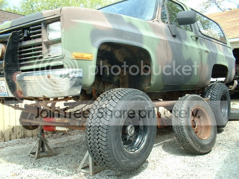

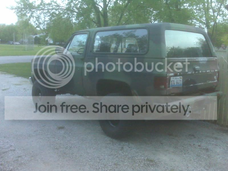

hell, my cucv is on 33's with the 14ff and d60, dont think ill ever break it no matter what i do, rather have that than bigger tires (though the 14ff ground clearence sucks, theres not alot of hardcore offroading territory around here)
