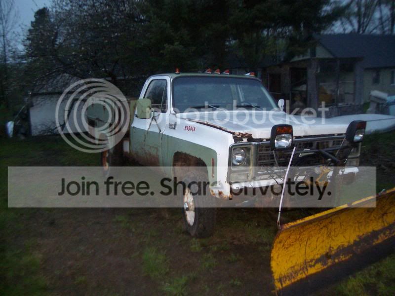

Arrived back with the loot safely!
Whew.. Made it all the way back! Man was that a bad idea to go pick that thing up as badly road ready as it was!
The P.O really didn't represent things as well as he should have. I should have known better but oh well, luck was on my side this time I guess.
Too bad I didn't try this post much earlier and leave time to have all the good replies I got here. I can see how the tips about the brake lines and fuel lines would have been really good insurance. I still packed the trunk of my car full of tools and a spare tire, jack etc... (And thankfully didn't need any of it) but I see some major flaws in planning to go get a heap like this thing!
At least the wife is finally getting the concept for the fact that her hubby sees gold in something that %99 of everyone else would call a turd! I gotta give her props for going to pick this thing up with me! :D
Here's what it has:
-Working Meyer plow setup with new actuator motor and solenoids. (1 still in the box) This thing seems really beefy. I'm told it was a city work truck for the town of Sagola, MI back in the day.
-D60 Kingpin front axle. No idea what the overall condition or specs is but it is puuurdy rusty on exterior. I think the hubs say spicer on em.
-14FF rear axle with said rust
-4 good snow tires at about %75 tread
-350 sbc engine runs fantastic and no oil buring etc. Looks like its been doing its own rustproofing of the undercarriage though with leakage! Seems a recent motor replacement was done.
-Looks like a hydroboost brakes? I've never seen this before but I've read through a few posts that I've seen it before in I think.
-SM465 trans mated to a ?? t-case? Pops out of 2nd gear when heavy load though, have to hold it in gear. I didn't check the 4wd to see how it functioned though I am told its fine.
I think I'll just basically fix some of the really minor stuff that was seriously "shade tree'd" like his plow wiring, exhaust leak "patch" etc. and use it for this upcoming winter to plow the huge driveway of our new place and bail out friends in the area when the weather hits hard. After that I will transplant the plow, motor and running gear (if worth it) into an 84 K10 I just got from down south. (Still gotta figure out how to get that thing up here from Georgia!) Then I'll take the blue fame wrench to er and haul off for scrap..
Here's a few pics for those who need a good laugh! :popcorn:
Is this hydroboost and if so looks like all the rust hardly makes it worth trying to save?? Man.. Am I LUCKY to have made it home with those brake lines!!??? :yikes: I can only imagine what's underneath this thing!
yes hydroboost brakes. :thumb:
Meyers plow o.k. setups for average stuff if you ask me . ( I am a fisher plow guy )
and yes those are the nice :D spicer hubs that can be machined to 35 spline when your ready to upgrade the stub shafts later on .
should be a 205 tcase. back of tcase between rear output and front output back cover should be a small 3 bolt cover . if so its a 205. and unless swaped in there was 2 years only of 465/203 . but you have locking hubs so its a 205 if stock.
good score . and I like even rusted to the ground k30 trucks for the tag/title for emmisions exempt in my state. :rolleyes:
