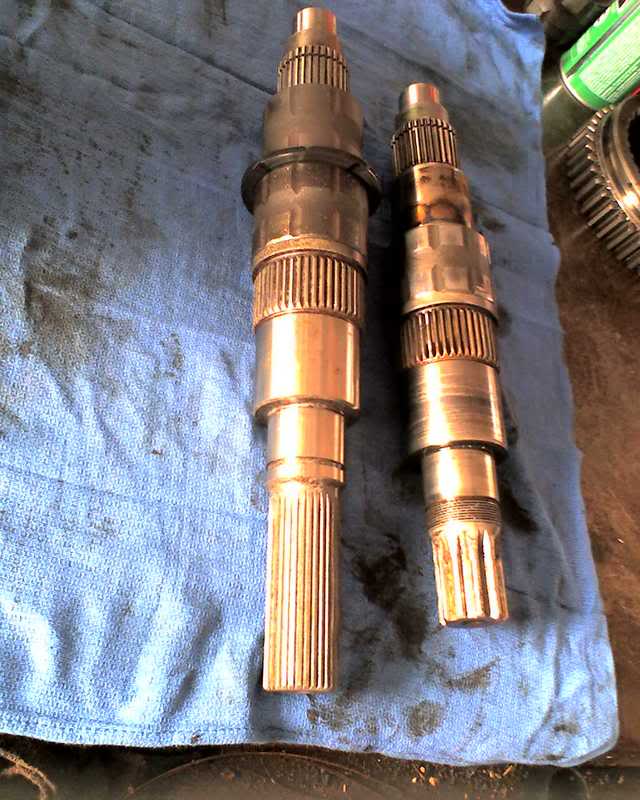

I didn't remember the nut from my 465 build so I went back and looked at a few pics, interestingly my ORD 32 spline shaft does not use one. :thinking:

I realize now that that schematic doesn’t have the nut op is referring to. None of the 465 main shafts I have used have had that nut, but they have all been aftermarket shafts.
