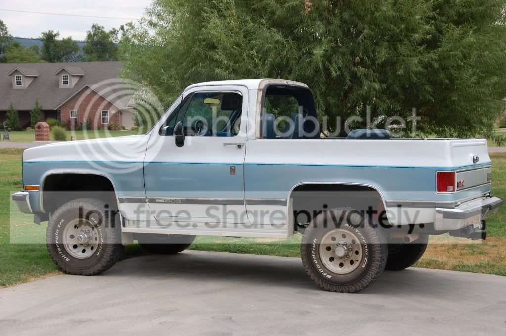

190 lbs sounds right. I was able to get in the back with the seat folded up, place myself in the middle with my back against the roof and squat thrust and walk that bastard off. Lucky for me my driveway descends below grade with a stone retaining wall. Eventually the height of the wall lines up with the height of an open tailgate. I could walk it right off and get it on the ground and crawl out from under it. Gonna have to call in reinforcements to get it back on though, maybe sometime after Thanksgiving.
Good lookin truck BTW. I like the white/lt blue color combo. What a difference driving it without the top on, don't ya think?
Hardest part was getting the seat belts off. Three of us lifted it off with no problems. I do wonder about putting it back on though. The clip that has the threads for one of the vertical bolts fell to the bottom of the pillar so now it is just a huge whole. I hopr the others side doesn't do that as well.
Dude! Your the first guy I've seen here with exact same truck as mine.:thumb: I changed my pinstripe to red.
Oh and mines an 89 so I don't have power mirrors or the shoulder harness bolted to the roof.
Here's how I take my top off.
