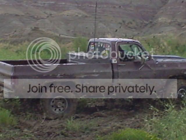

leave the 2" and cut fenders. Here is old brown with 2" and 38s. No inner fenders and hacked fenders. Only decent pic I have i think
