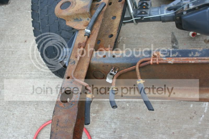

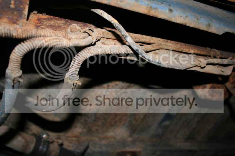

Pretty sure it goes to charcoal canister - can't remember where it was though - must be up front - but there are (3) lines bolted to the body on the rear to route venting fuel all over in the back - I'm thinking those must be for incoming fuel into tank?
Frame:
Mating hoses on body:

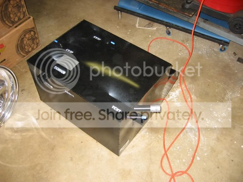

Also, for the pump - I have a NWF aftermarket 26 gallon tank
How would I go about finding in-tank fuel pump for this? Or are they universal?

Is your new tank baffled?
