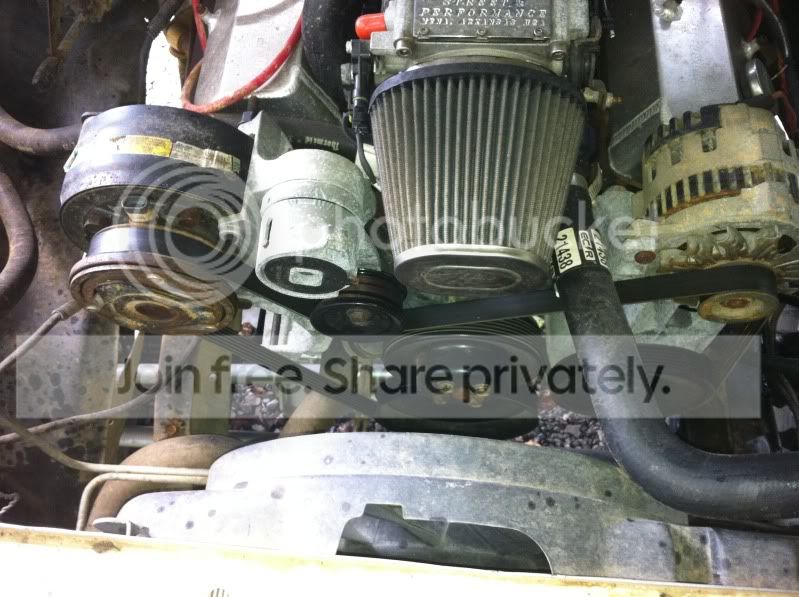

I can run outside and try to get a good picture of my TPI serp setup in my blazer. Like others have said, I believe you'll need a A/C delete pulley or do like I did and just have an old compressor, make sure it has oil in it, cap off the inlet and outlet ports, and use it.
Pictures are going to have to wait till there is a break in the tropical storm rain....
Hope this helps, I really need to clean my engine up...

It can be done without an extra pulley.
I have the same setup like the pic above, but no compressor mounted.
The only thing different is the belt runs backwards on the idler. IE ribs against idler.
Sure, it may not be ideal, but 5 years later it's running the same gatorback belt with no issues. I did replace the idler pulley once.
I was planning on setting up a gm compressor for OBA but seems like someone already snagged all the junkyard ones around here, along with the delete pulleys.
I would run the ac delete pulley IF I could have found one.

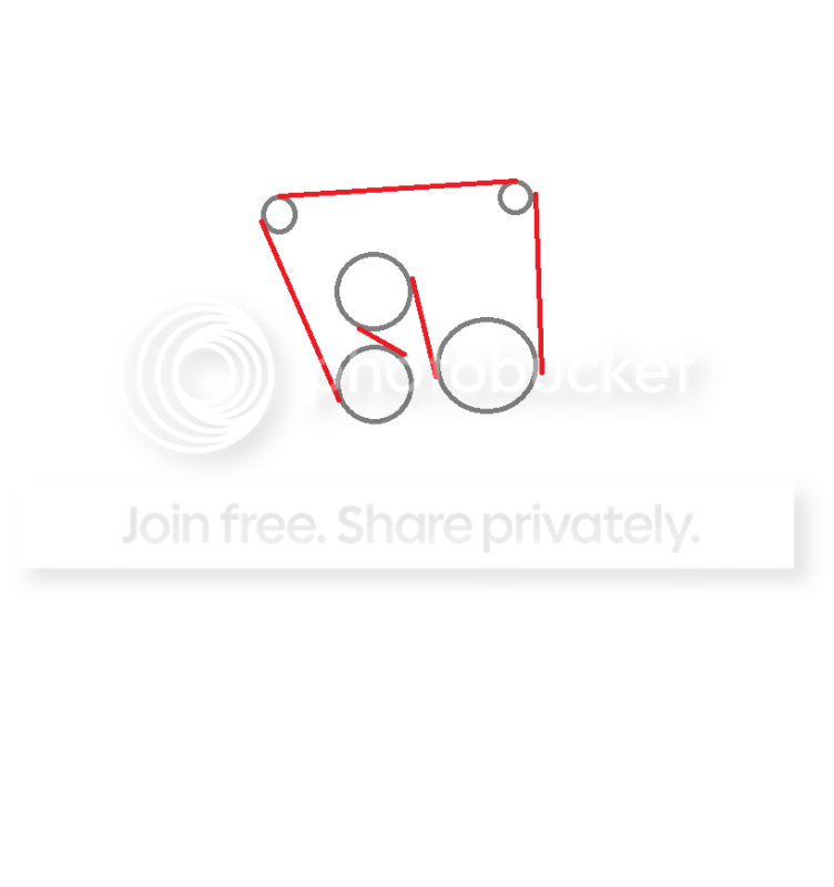

Here is how it's routed. I ended up having someone hold the tensioner halfway in its travel, then wrapping string around the pulleys like the diagram below to get an approximate length. Then got a belt. Get 3 or 4, some longer some shorter then take back the ones that don't fit.
Like I said it's not ideal but has been running fine for years this way.
I forgot all about looking for an ac delete pulley a while back since this worked. Guess I need to start looking again!
