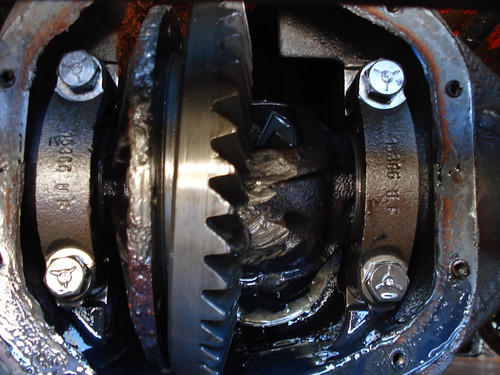

At the last trail clean up 4x4 did not work. Everything was spinning but the front end.
I'm feeling a bit better and thought I would tear into it to see if I could fix it quickly (like broken spider gears) so we could use it to help build the Carnage Canyon Challenge Route this weekend.
Here is what I found.
What this truck really needs is a front D60. Anyone have a spare?

Lol did you shear the ring bolts from the carrier?!
Thats a hell of a break. You definately need a 60 infront of a big old 3+3.
