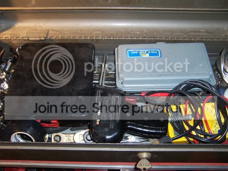

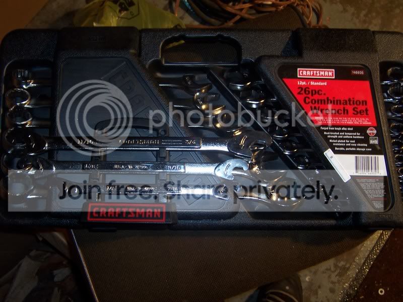

Complete Set of wrenches as well as a 6 set of wrenches for rounded out bolts (those things work great if you've ever wondered)...

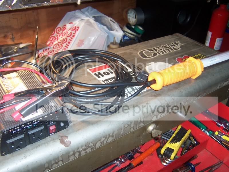

My big power inverter and a work light (figured I might have to work w/o light in many cases especially if I'm away from the camp out in the dunes...

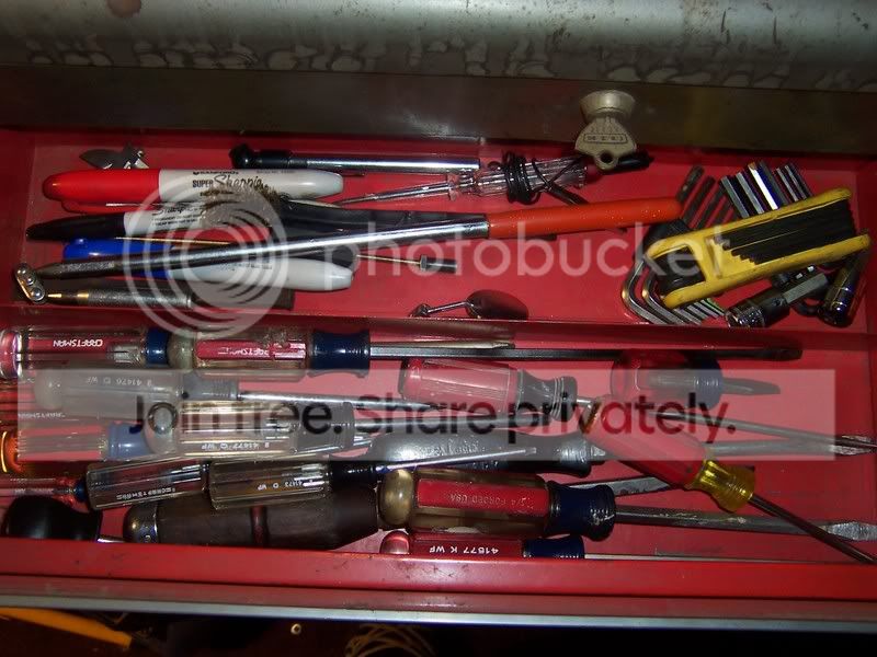

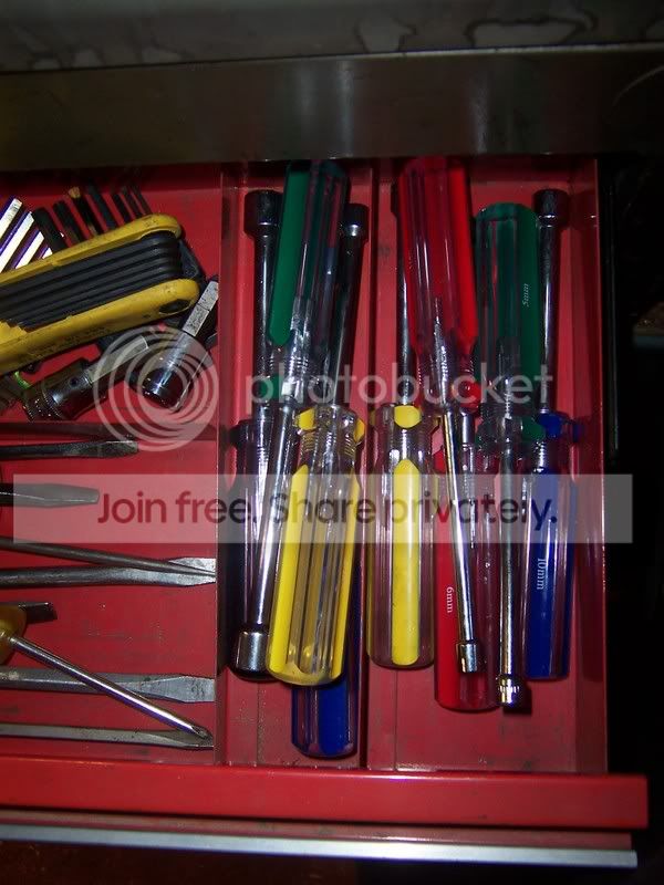

Philips/Flat head screwdrivers, Allens, sharpies (you never know :)), magnet, wire brush, test light, misc. stuff...
Set of metric and standard socket wrenches...

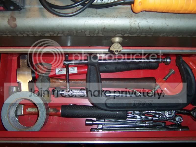

Rubber mallet, hammer, BFH, duct tape, C-Clamps, every size socket drivers and lots of extensions and my big torque wrench...
Complete Drill Bit set, hole saw set, step drill set, soldering stuff and my meter...

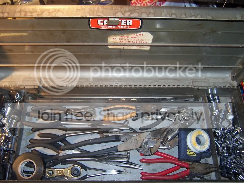

Standard sockets on the left, metric sockets on the right and pliers/vice grips in the middle...

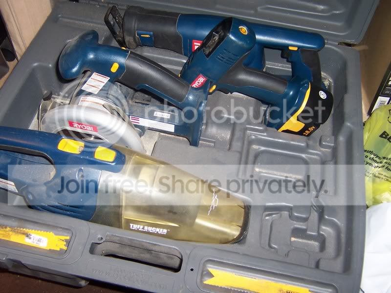

I'm not taking this whole thing (I could but it seems like a waste of space) but I'll take the drill with two charged batteries (and the charger) and the sawzall with a couple metal blades...

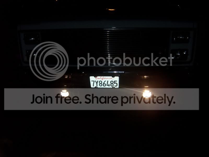

On a side note I just got some new flood-lights wired up and ready to go for some night rides in the sand...

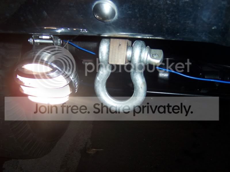

As well as finally getting a couple tow points for the front of my truck...my friend was always giving me a hard time saying anyone who goes out (even if its just in the sand) w/o having tow points on the front and back deserves to stay stuck...lol...he said there's no shame in getting stuck for us noobs but don't be an idiot and not have a way to get yourself out! :)
So I welded short blocks to the front of the frame rails, drilled a hole in them and bolted some big D-Rings on...I can't remember what their working load was but I remember it was plenty (found them at the hardware store)...

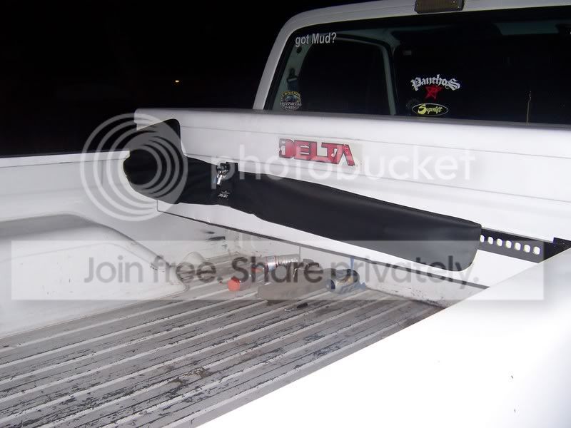

You should get the flashlight that goes with the Ryobi set , mine came with it , it throws out a hell of a lot of light :eek1: .
Looks and sounds good all but the welded on tow points i hope your a good welder. Not to discredit your skills i just prefer a few large grade 8 bolts for tow points. I sugest you take a spare tire:haha: and some hubs.

Dafey: I have it, it mounts in the lid and although I'm sure I'll take it I have my mag light in the truck...
original blazer: yeah I've been kicking around how to mount my tow hooks for weeks now...the tow hooks I had would work b/c they would hit my bumper if I tried to bolt them to the frame on the bottom...I couldn't moun them on the inside b/c I have a 1/2 ton truck so its a "C" frame so the hooks couldn't be used inside the frame :), and I couldn't mount them on the outside of the frame b/c thats where the front of the spring packs mount to the frame...
I was questioning this at first too but then we just decided to try it out and see how it went...obviously you don't want to play around with tow points as if someone gets hit with a strap that breaks off it could be deadly...
To answer your question I started to weld them but decided it was best to leave it up to the professionals so I had my boss lay the beads around them...I ground down the edges of the blocks so when they were up against the frame it would create a valley...so when he welded them it penetrated the frame then filled in the valley then down onto the block...they are super short too b/c I didn't want any extra leverage....anyways I hit them with a BFH and they didn't even budge so I called it good...I'll only use them as an absolute last resort though until I can figure out a better system (time for a new front bumper! :))

quick tip on the d-ring - consider throwing a zip-tie thru the eye of the bolt and then running it thru the D. my dad's lost a few because the bolt rattled free from the d while cruising around.

You can run a 4.5 inch grinder off the inverter. Cutting and grinding discs have been useful on our trips. :wink1:
Yeah I have a grinder that I was going to take (can't think of anything that I'd need that for as it would be sort of major) but I was doubtful that I would be able to run it off the inverter for very long w/o sucking the battery dry....when doing stuff like that do you just have to leave the truck idling?

If it is on the bottom of the frame I would have at least beefed it up with some 1/4 or something then welded them on . Bolts really are preferred and many places will tell you to hit the road with welded towpoint's. I hope that you realive a hammer won't knock them off , but a hard tug will , or will bend the frame.
