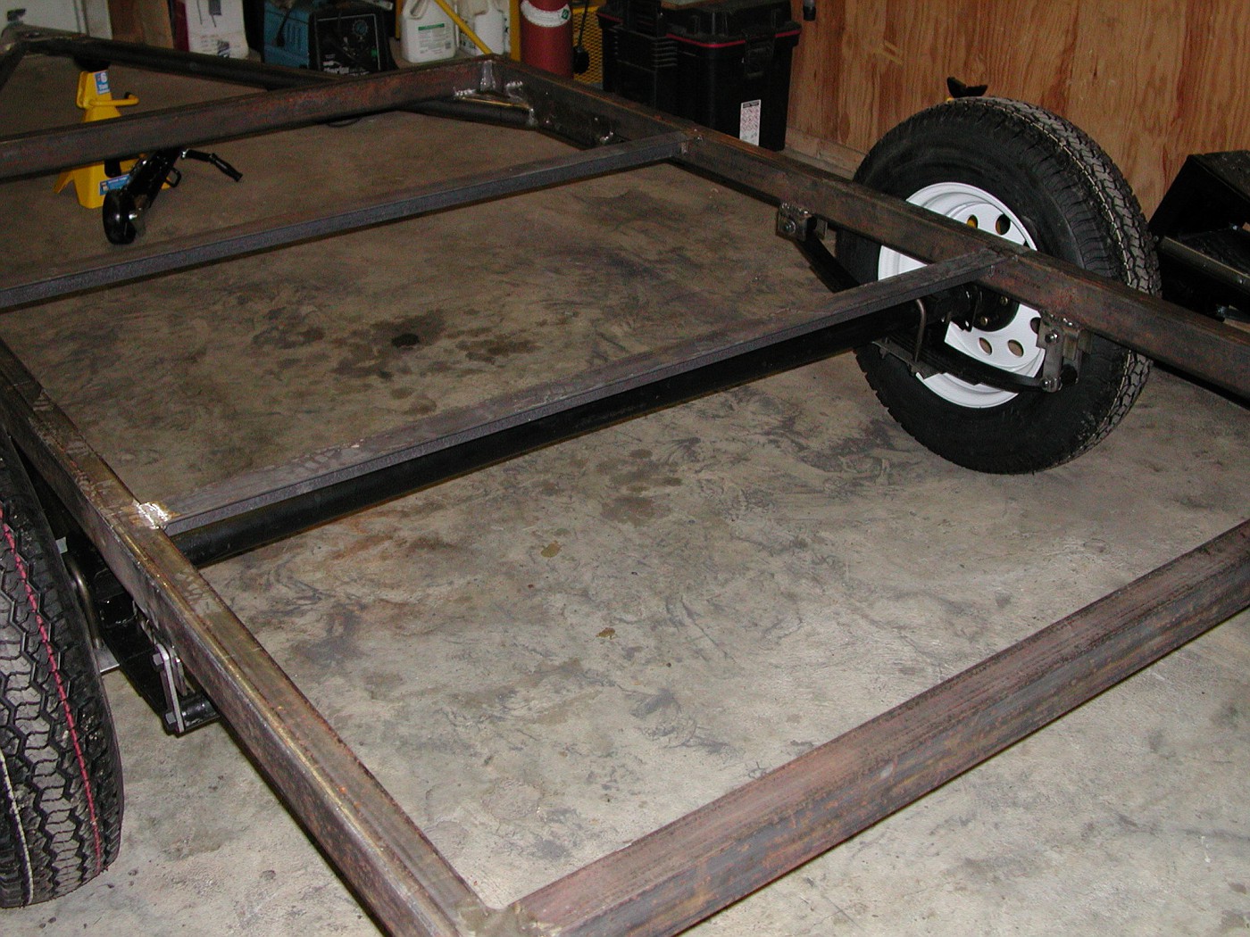

I bought a 3500Lb trailer axle with leaves and all the mounting hardware for $178.00 Canadian...it was on sale.
$17.00 Canadian for a Trailer wiring kit,includes side markers,wire,rear tail lights and Lic. plate frame...again on sale.
The 2" A-frame hitch part was only $14.00.

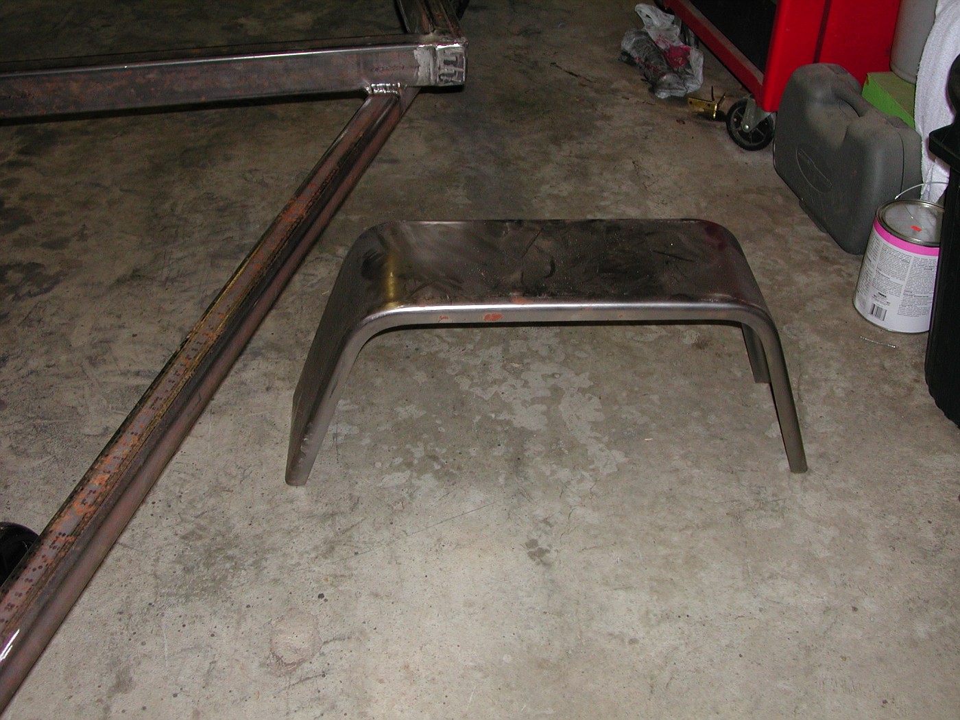

Fenders were $14.00 each

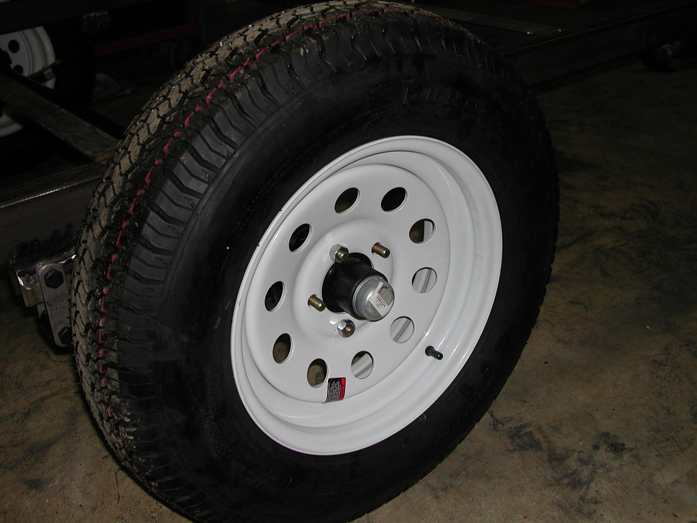

The tires/wheels I got at an American TSC for $80.00 each,15" rims with ST205 6 ply trailer tires.
All the steel I got locally.

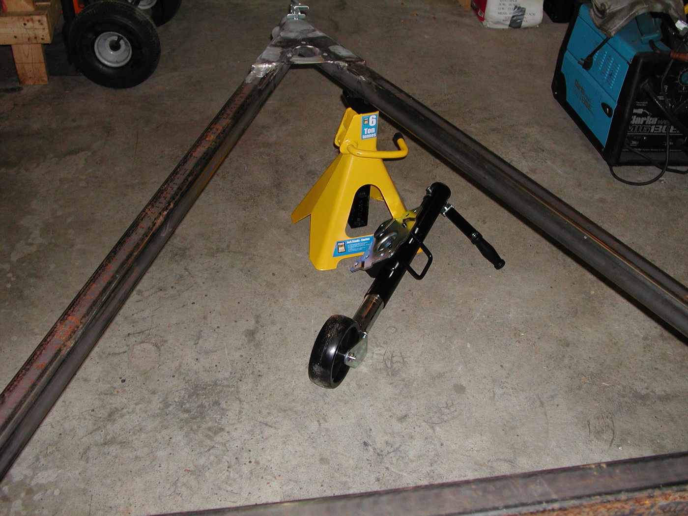

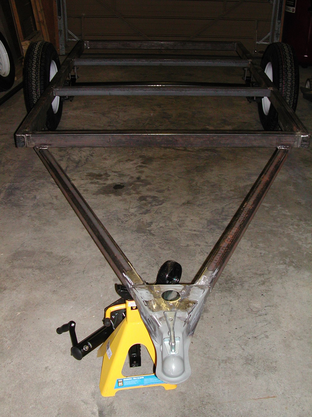

I'm not done yet but this is what I've got done so far.It's 5x8
This 550lb trailer jack was only $21.00...on sale.
