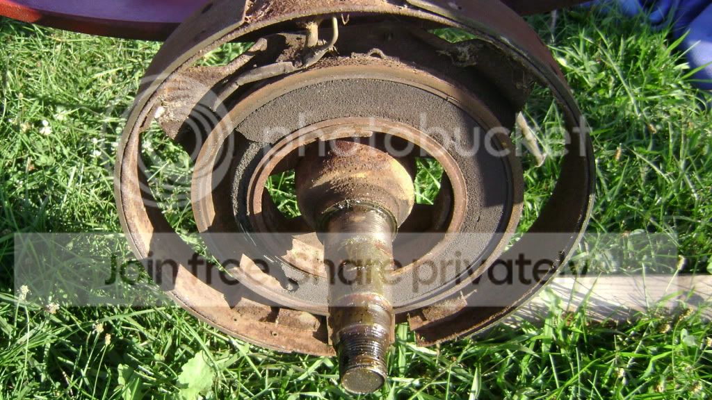

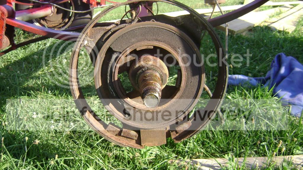

My dad and I bought this trailer recently. We figured it would need new brakes but I have no idea what kind of braking system this is, I don't see anywhere to buy replacement parts. Can someone give me the name of this system or point me in the rite direction? Thanks.
Thanks, I checked for numbers and didn't see any. I will look more thoroughly tomorrow.
The championtrailers main website has lots of info as well. Might be able to find what you need there.

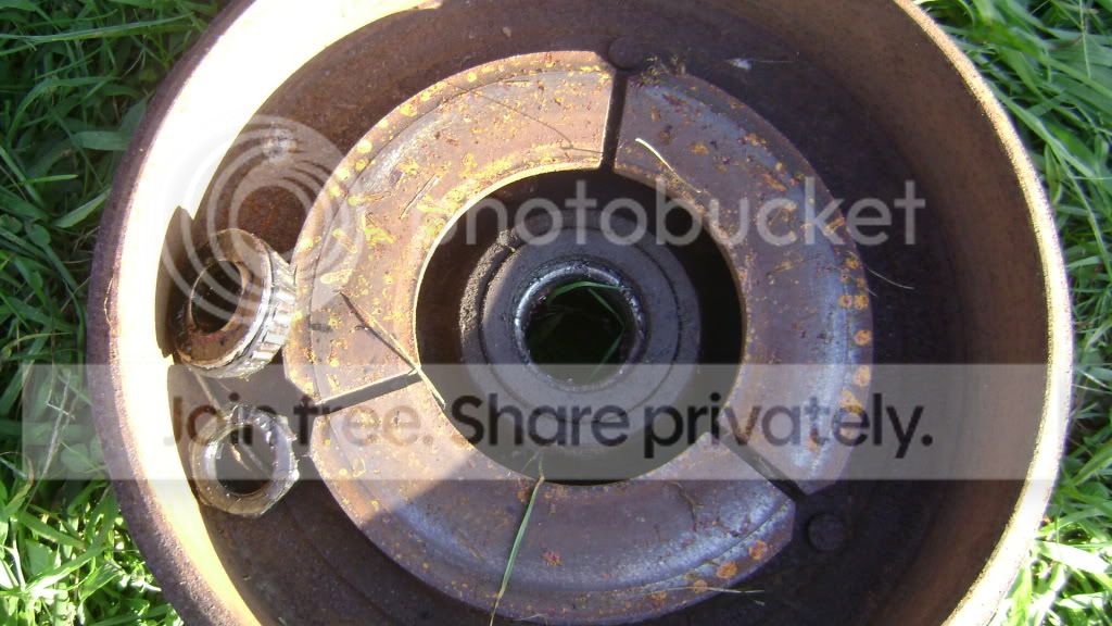

I would have that's a big chunk of the magnet missing. I'm sure they'll kick on when energizer but, that's one
big old magnet!
