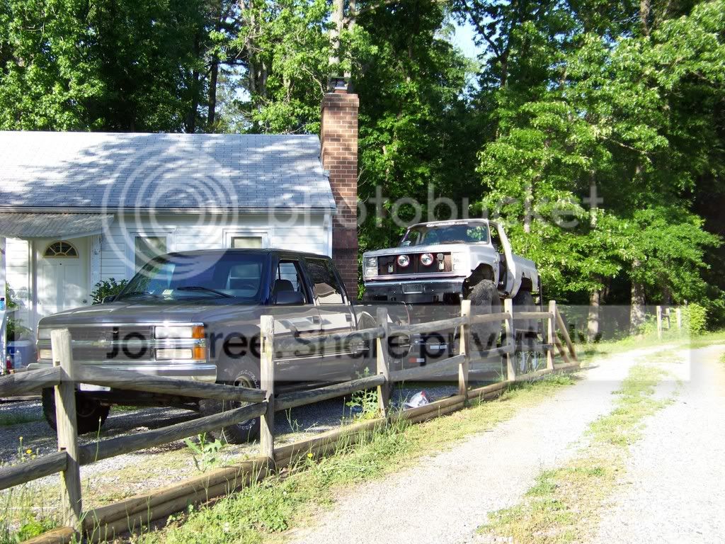

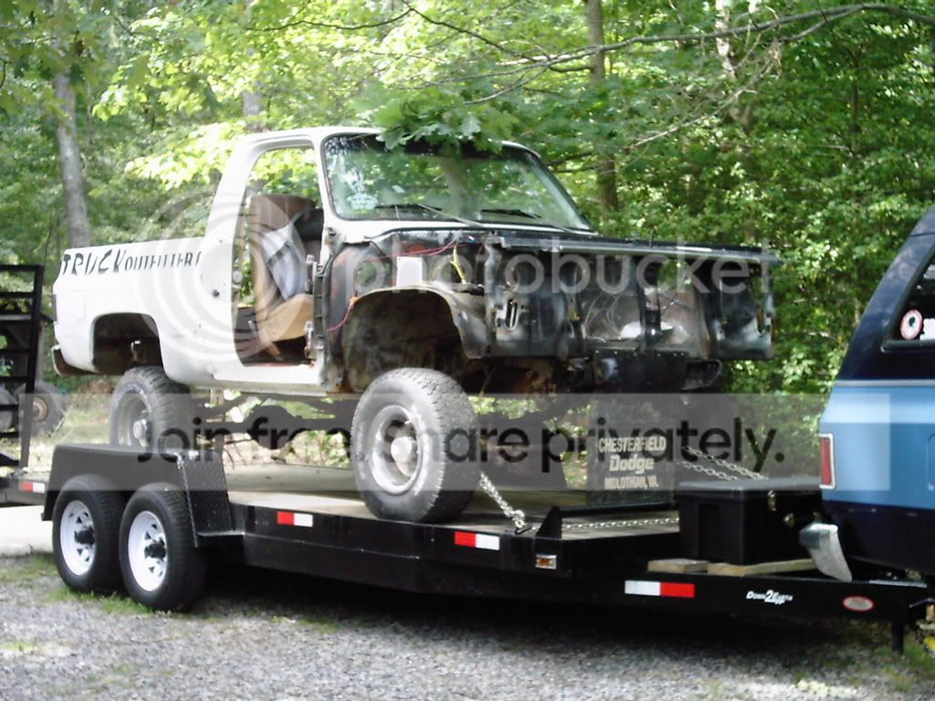

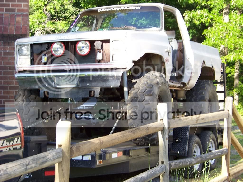

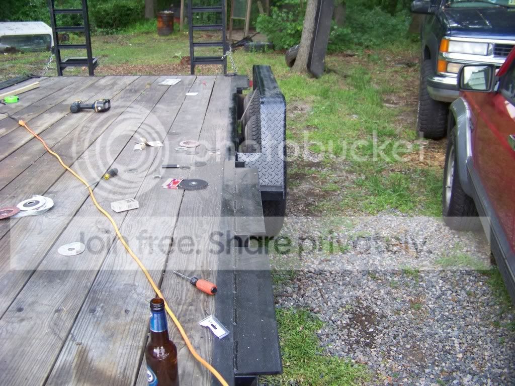

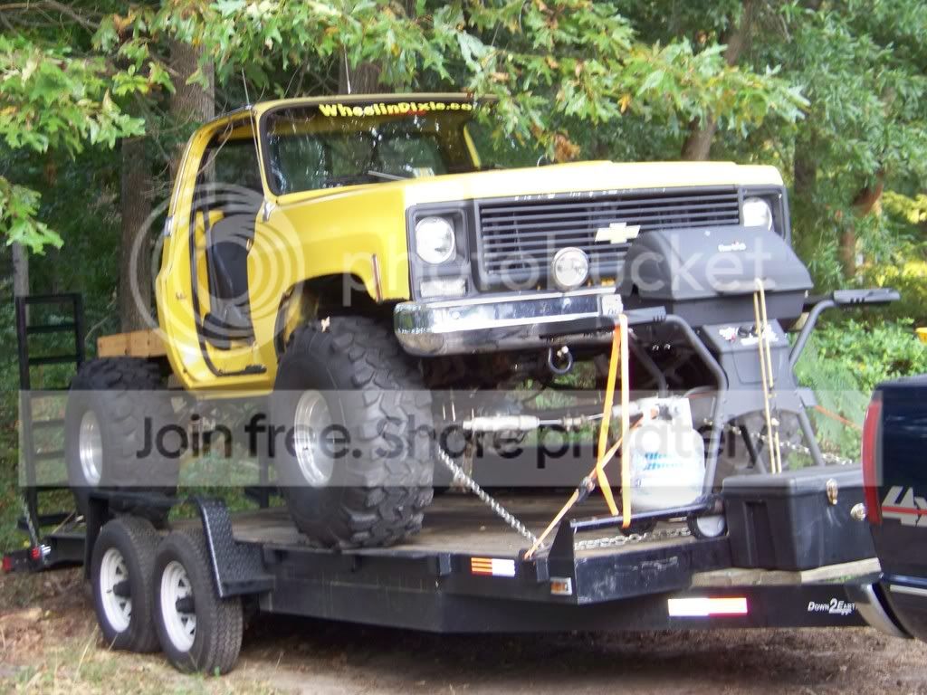

here is what i use
20 foot 10k

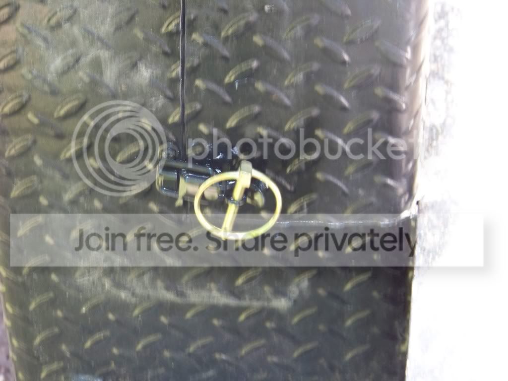

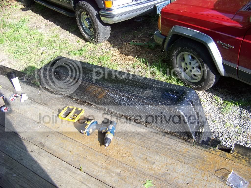

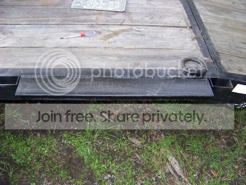

here is what i did to make my truck fit on it
and it fits with h1s and 44s
39s as well
I like the way you cut out the fenders, that's cool.:waytogo: Now I gotta look at mine to see if that'll work for me. Nice truck, too.:D
i tore the pass side off coming off the trailer one day but i like it better like that i dont have to flip it up and down i just worry about the one on my side i dont have to get out the truck to flip one down to finish pulling it foward seeing as how i but the tire up next to the fender
which truck lol..the blazer is gone but im currently working on the yellow flatbed
Yeah, I was wondering whethet I should even make the panels removeable or just put a brace on the fender (mine are differnet style). I can see how it would get old swinging them up and down. I was talking about the blazer cuz I didn't notice the flatbed first time. That one looks sweet, too.:D
