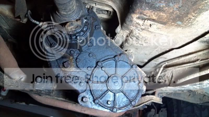

So, the previous owner told me that my 88 had an NP208. I've been having noise issues with it, so I changed the fluid today. I used the Dexron ATF.
After looking at it some more and thinking that the fluid coming out definitely didn't look like ATF, I started researching what the NP208 should look like.
After comparing mine to pics on line, I'm pretty sure it's an NP205, which should take 90w gear oil instead of ATF. I plan to drain and fill it again with the 90w, but is there anything else I need to do? Flush? Disassemble??
Also, the shift pattern seems to be (top) 4h - 2h - neutral - 4l (bottom). Is this consistent with the NP205?
Here's a pic:
looks like a 205 to me.....gear oil....75-90w
a little ATF isn't going to hurt anything.....drain it and refill w/ gear oil..:waytogo:
Curious what you mean by "noise issues", 205's are all gears inside so they whine a lot, is that what you were worried about?
... and to reiterate what's already been stated, mine had ATF in it and I switched to 80w90, no problem running either (and congrats on the 205 instead of 208)

Agree with the others. definitely a 205. Rumor was that they had you use atf if you had an auto and gear oil if you didn't.
I have an auto and mine had atf in it when I bought it but I have been running gear oil since I got control of it.

Thanks guys! What about the shift pattern? With it in what I think is 2h, the front shaft won't move by hand.
This is what I think it is.
Way forward is definitely 4 wheel drive, but it doesn't feel like 4L at all. And neutral is definitely neutral. I haven't tried it in 4L, so that's the only variable. But there is a definite difference between what I think is 2h vs. what I think is 4h in the amount of drag in the front end I perceive.

on my 205... 2H and 4H is about a c unt hair apart... real small. Start out in N... then short jerk back should get you into 2H... you may need to play with it a little.
then turn driveshaft and see...
