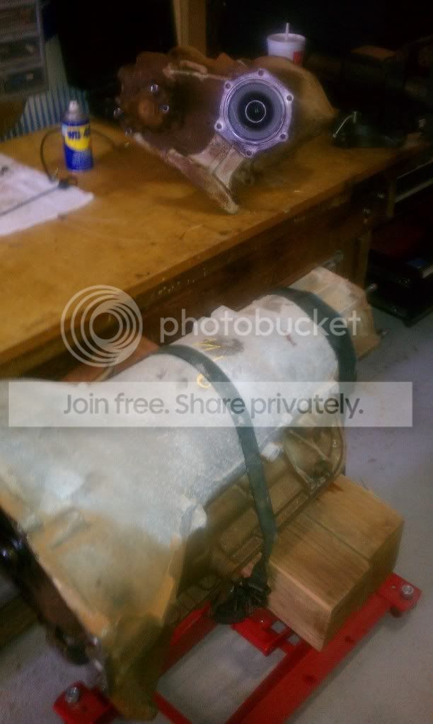

Can anyone recommend a jack or rig-up that makes a transfer case less of a ballbuster? I used 2 jacks and a whacked up,screwed together TJI/blocks to do it last time but that still required the no-show help to show:whistle:

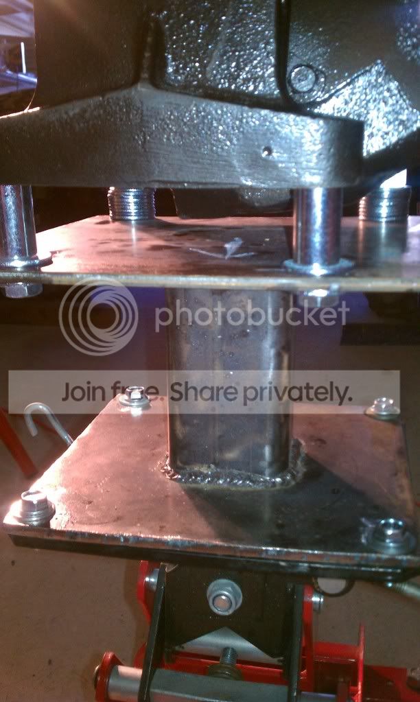

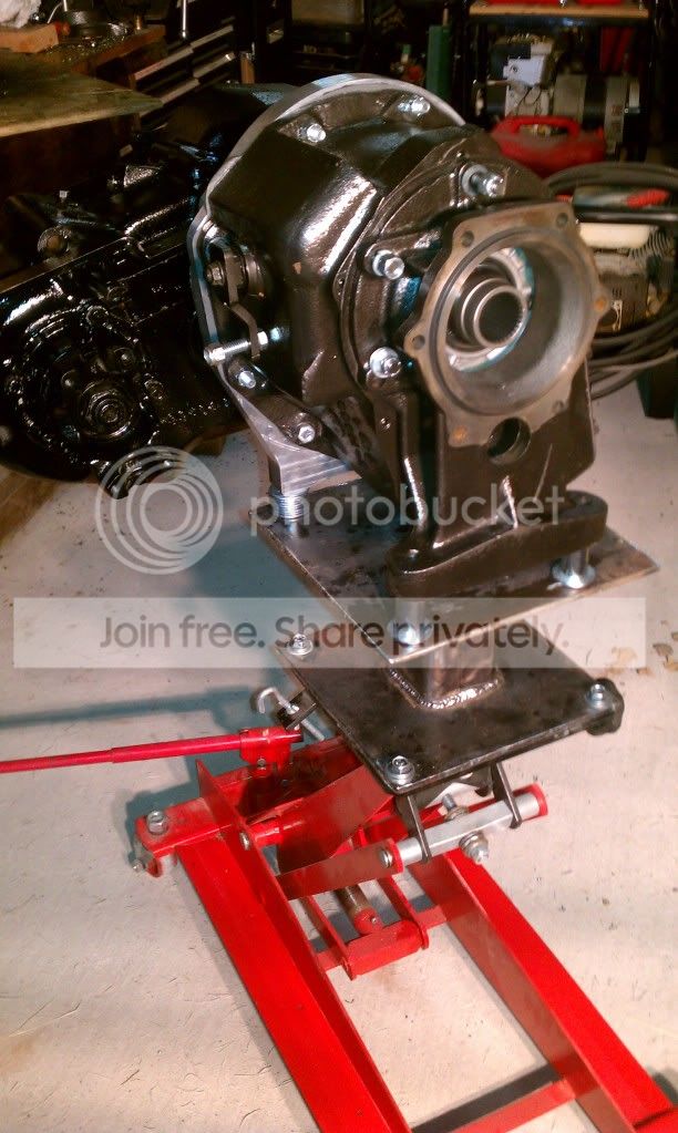

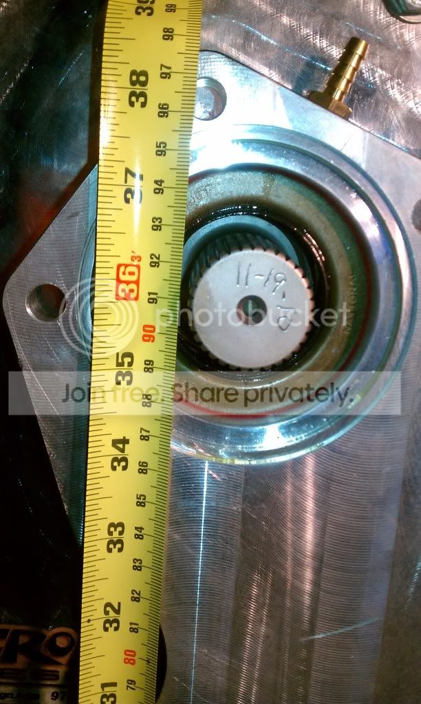

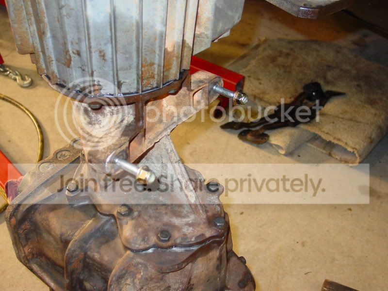

Here is how I built mine..... 36" high at the center shaft at full extension.... I can handle a T-400 and a complete doubler ( assembled ) myself.... :)

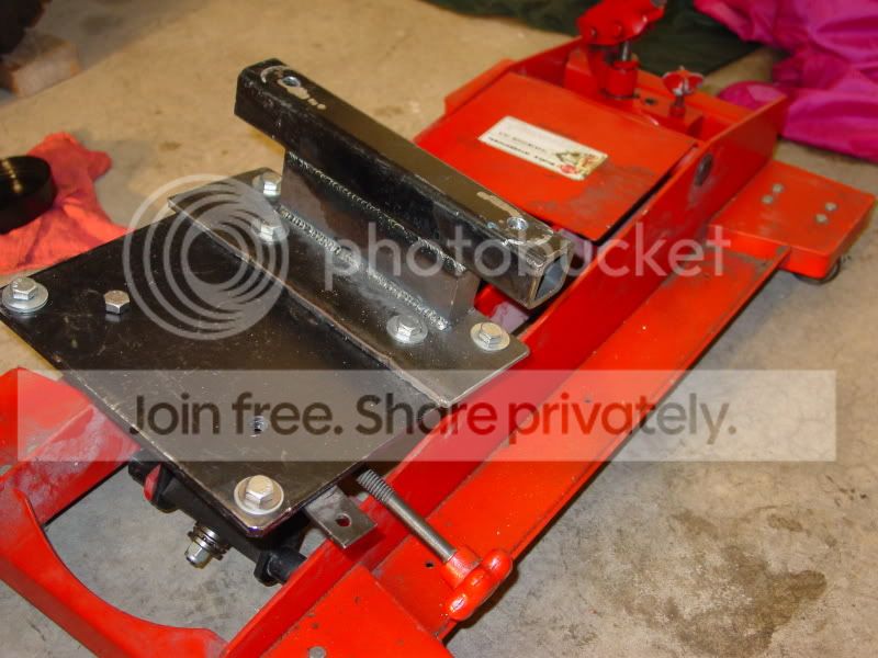

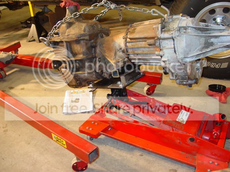

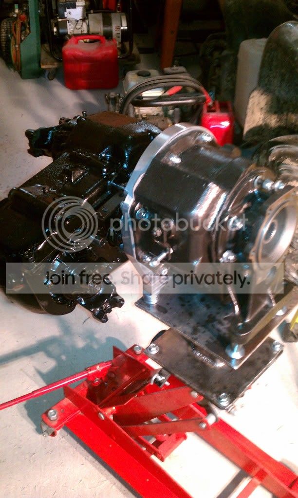

Here's what I did with my trans jack:
So this example shows a very different transmission and t-case type from the example above, but the fabrication involved is really simple. Less than an hour of work barely will save you plenty of headache later! Good luck!

:woot:Sometimes,just SOMEtimes I say,inlaws come through for me...wifes cousin has an adapter platform just like in Highpsi's pics :bow: Thank You for showing me what the h*ll that crazy looking thing is for :waytogo:
