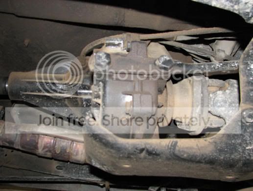

I have a 1987 K5 that I use for some mild towing. I am paranoid that the 700R4 will someday leave me by the side of the road. Rational or not, I want to upgrade (downgrade?) this transmission to a TH400 or TH350 for my own piece of mind.
First I want to confirm what I think I have (because I am not as familiar with this “later” Chevy stuff.)
- 1-piece rear main seal (and its associated flywheel bolt pattern)
- 208 Transfer case
Does this sound correct?
I would like to find a TH350 or Th400 that will fit in to my existing engine/xfer case combo (if such a tranny exists.) If it doesn’t exist I would like to find a transmission/part time xfer case combination that would require minimal modifications to engine, crossmembers, and driveshafts.
Where should I look for such a transmission?
I am familiar with the “earlier” 73-87 drive trains and I am comfortable with rebuilding a TH350 or TH400.
Thanks so much in advance for help with this project.
i can't see the pictures since i'm in school. but yeah most likely a 700r4 to a 208
you can find a 400 (the best idea) and then put a 205 behind it while you are it since it is stronger and will be easier to swap since either way you have to have your driveshafts extended/shortened.
