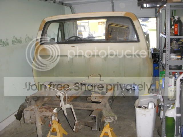

Well I've neglected my 90 k5 project for a while due to some illness in the family and some bad times in the oilfield, but I'm ready to get back into it. My original plan was to one ton my K5 6.2L diesel, NV4500, 203/205 doubler, Dana 60 front 14bff rear w/ 4.88 gears, 52's in the front, shackle flip in the back. Ive been lurking and really liking the whole trazer truggy idea, and have reached a dillema. I have a M1008 waiting for me when I get home from offshore, complete except for the driveline ie frame, body, and everything not directly attached to the motor, tranny or axles. I also have a custom motor cross member/panhard bar setup that was designed for the blazer frame.So my choices are to build a trazer on a clean Blazer frame I have prepped for the B52's and shackle flip, build a truggy of of the one ton frame, drop everything into the M1008 as a full size or stick with the blazer body. The truck will be used as a hunting and fishing vehicle, and rocks up in Tennessee when we move up there next year (building it not to break up there, not much hard stuff in Florida). Let me know the reasoning behind your votes if you will....Dave

I currently have a Trazer. Im picked up a M1008 to rob axles out of and the plan was to scrap/sell the rest. Ended up keeping the truck because of how much beefier the frame is. I ended up shortening the frame, boxing a few sections, and cleaning off all the brackets. I will be doing a 4-link rear and a stock lift spring up front. Wheelbase will be close to the same as the trazer.
I didnt see a point in building a overkill rig on a basically 1/4 ton frame. The blazer frame is about 1/8" thick were as the M1008 frame is 1/4" and much taller channel.

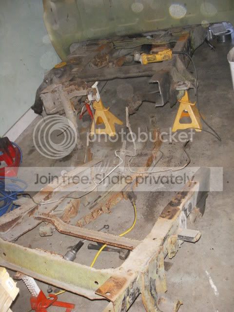

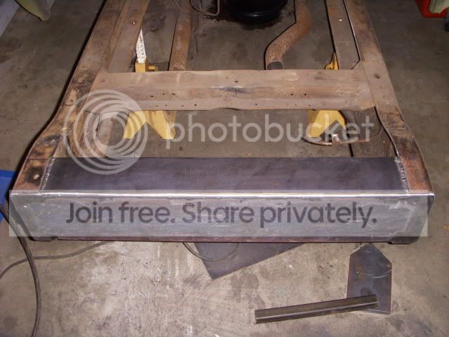

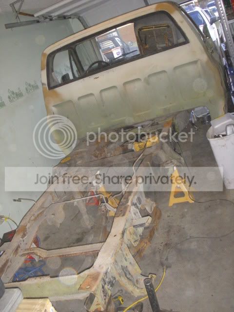

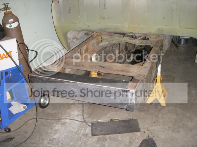

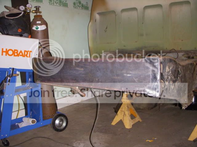

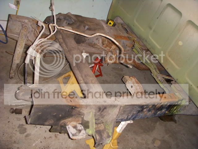

hmatiak do you have any pics of your M1008? Interested to see what you did.
That should give you a good idea. Wheelbase will be 118-121 with 42's. The axle housing will be 3-5 inches from the end of the rear of the frame rails. It looks a little different now with sections of the frame boxed.

I like the way that M1008 is plated across the rear. Hmatiak, you said you boxed sections of the frame. Does that help overall, or just make the un boxed areas more likely to fail? I'd been thinking about just welding in 2" wide 1/4" plate stiffiners about a foot apart add to the rigidity of the frame, while still allowing access to the lines running behind them and not having to reroute everything outside the frame. You guys think that has any merit?
I'll be using leaves also. One question to you gurus out there. Since I've already got my axles built and pretty with a 3/4 ton rear end to match the blazers spring width, how hard would it be to adapt the spring mounts on the trimmed one ton to mate with the 3/4 rear end. Just wider mounts on the frame, or is that not a good idea. I want to do a shakle flip in the rear, I imagine I could get Kurt to make me a set and a set of front hangers to correct the width issue with out cutting and welding on my pretty 14 bolt.
The hangers you are talking about making would create more leverage on the mounting surface. Use the correct/factory style mounts or inbord the rear springs to under the frame rails. Either way you will need to move your perches.
I boxed from behind the rear shackle hanger for the front springs to just before the rear body mounts for the cab. I tapered the ends of the plate were it stops like a sideways "V" to help distribute the force back evenly to the un-boxed sections. I boxed that area because the 4 link will work much better on a rigid frame. Also gives me a nice area to build my brackets off of and to mount new cross members inside of the frame rails. It seemed to me that area of the frame would do the most twisting when the suspension begins to be worked hard.
