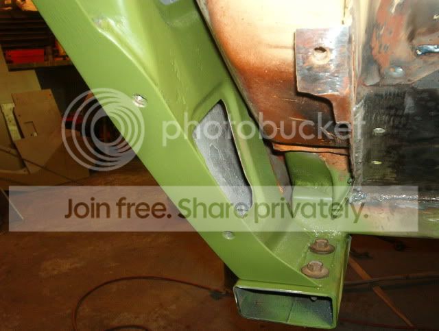

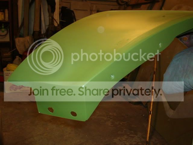

here's mine moved back 5"... excuse the rotted wheelwell...
it worked out so all i had to do was bend the well kinda flat in the back.. even with the firewall... here it is without the well..
if you ignore the slider, chopped off bottom, new mounting of it, I basically added a 1/8 plate to the cut lip...
I was wondering how you attached the fenders on the bottom with sliders. Great picture, nice work. :thumb:
Btw did you cut the bottom of the doors off for the sliders. :dunno:
Just would like to know cause my door bottoms are shot and so are my cab corners.
alot of people replace their ROCKERS with weld in sliders, not the bottom of the door itself. There are even venders with readily available bolt in sliders.

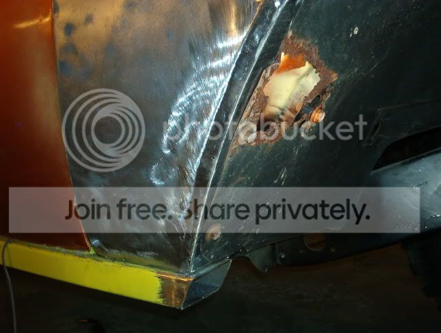

well when I did mine, I cut it a bit less than I needed and took a ball peen hammer and a dolly and went to town, bending the outside piece in and the inside piece out and overlapped them, I was going to tack weld them but never got the chance, I ended up scrapping the truck before long, but I have my wagoneer done the same way and I can take pics of that one if you want.
I added pictures to my second post.
Thanks for the pics Ryoken, it helps a lot.
Thanks for the input guys. I was thinking about putting some filler metal strips in and this helps make up my mind on what to do. I can't really mess it up much further. LOL.
Wow, you really want saw-zall happy on that. Id try and close those gaps up with some strips inserted or hammer on it to close it up and maybe tack weld it some.
