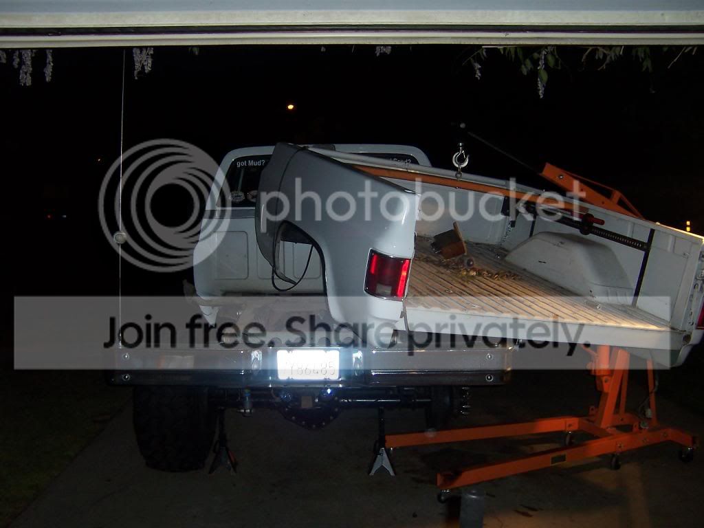

They're not that heavy. Like diesel4me said around 400 pounds is a good estimate. I could move mine around by bumping it but if you want to pick it up here's how I did it by myself.
