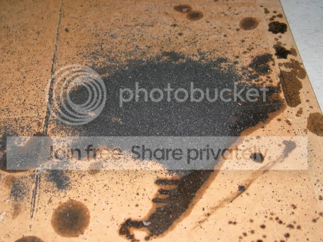

Underneath the truck, the floor is covered with little black grains of what I assume is carbon. If it's been doing this all day, then the cats probably are plugged. It has to be super rich to do this, doesn't it? Maybe my wideband O2 sensor is calibrated wrong. With the exhaust disconnected it measures way lean, but that is because it is mounted in the header collector, so it's like 1" from being in free air.

So I am pumping out carbon. Why and how do I fix it?

So I'm focusing on the question: why is my engine making carbon?

This seems ridiculous. I must have about a cup of this carbon on the floor now. Both cats are completely plugged with it, of course. Can the engine really produce this or have I sucked it out of my charcoal canister?
