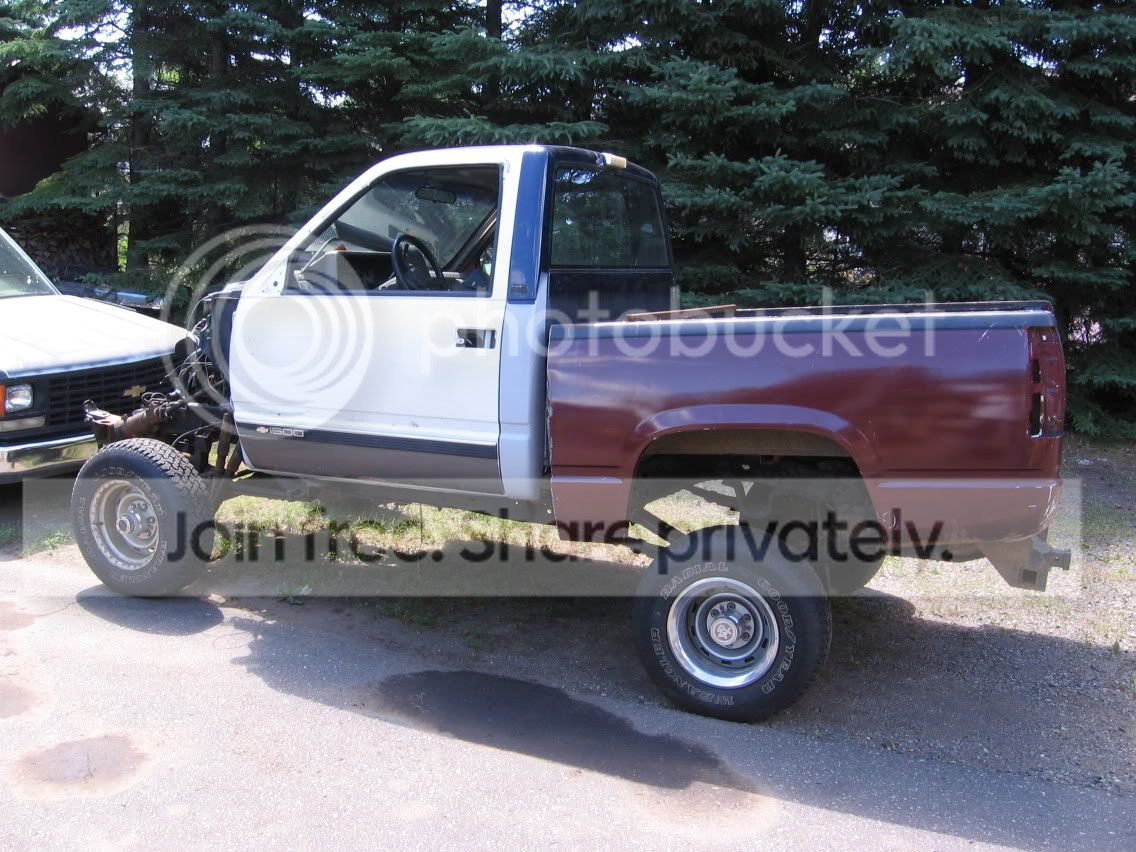

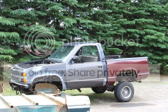

Lots of guys have done it,look in the photo gallers...I looked at pretty much every photo in there a few weeks ago and theres really awesome stuff....My blazer is an 87 and I have a 88-98 Reg cab on it..The cab is bolted to a subframe bolted to the stock bodymounts...Lots of cutting fabbing and welding,but worth it...To keep the 73-87 body,I believe its only making a rear cab crossmember and I believe you need a bodylift on the front of the cab to clear the raised part of the frame right behind the doors...Then shorten a bed,and relocate the fillerneck or build a kick ass flatbed!
theres a couple nice ones around town here......

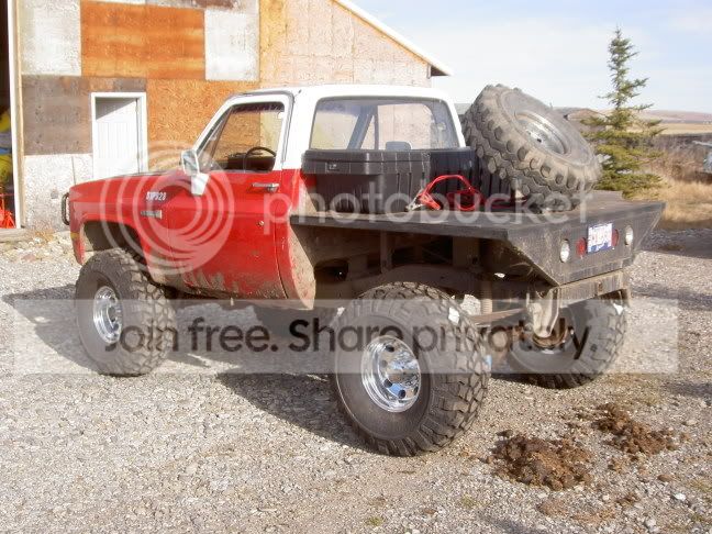

The flatbeds are awesome,but Im biased I guess,I love just about anyflatbed.Ive decided to ditch the box idea we had goin for mine and just flatbed it,its an ongoin project when I find the time to tinker with it....
Hey DEMON44,I hear the wheelin is great out that way and theres always lots of people wanting to go on weekend trailrides,so theres gotta be some 4x4 clubs around the area? My girlfriend and I are probly going to be heading out that way for work late fall,and having people to wheel with would be a bonus!
kadillackid, theres some great terrain around here. from flat land to bad lands to rocky mountains. the bad lands in Drumheller are pretty killer.
