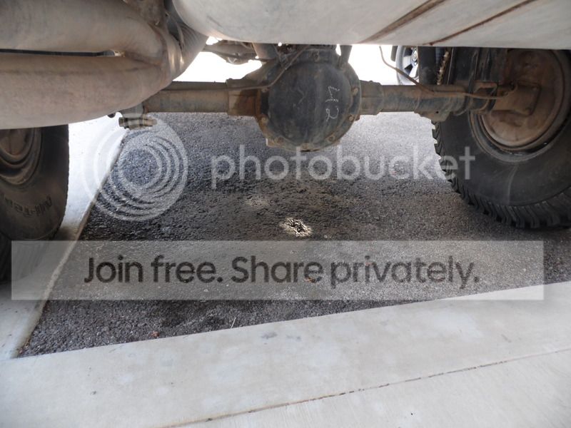

Rear diff decided today it didn't want it's fluid anymore.

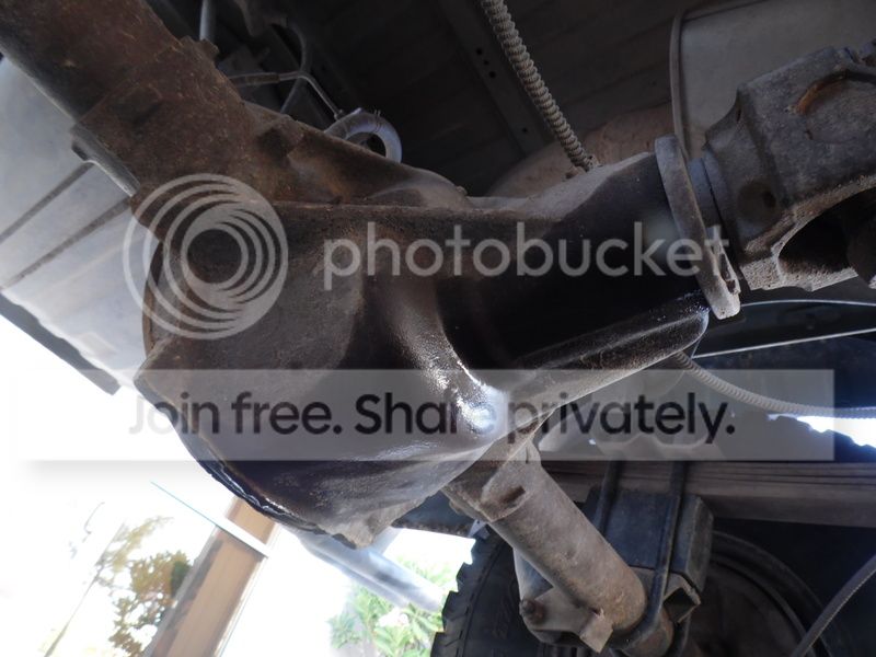

Actually folks, I need some help. Its leaking big time from the pinion. How do I fix that?

Edit: didn't realize it was a pinion leak.Sucks to do right as you'd technically need a new crush sleeve and all the fun that comes with it. Some guys have had success counting threads exposed, removing the yoke, replacing the seal, re-installing the yoke and tightening the nut carefully to the same depth that it was.

Mark the nut that holds the yoke

If the pinion isn't loose already, it's replacing the seal, and hoping you can get the pinion bearing pre-load just right. Lots and lots of posts on how to do this. Basically on a used crush sleeve, it's luck.
GM book-method is measure the *in-lbs* required to turn the pinion first, then do your work, reassemble, then torque a couple more in-lbs than you started with.
That's how the 1Aauto video shows how to do it. I'll give that a shot.
I've had good luck just replacing the seal.

You can mark the nut to pinion if you want, but as long as you use a little loc tite on the nut and dont get stupid tightening it you will be fine.
The in/lb wrench wont do you any good unless you tear it down to just pinion installed in housing.
