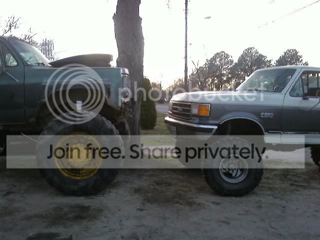

and here is another pic
my truck (left of course) and my brothers f250 on 6 inch suspension 3 inch body on 38 boggers ( on the right ) :haha:

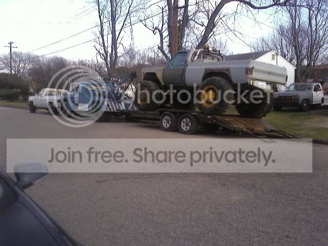

here is the truck on the trailer . . kinda fits lol

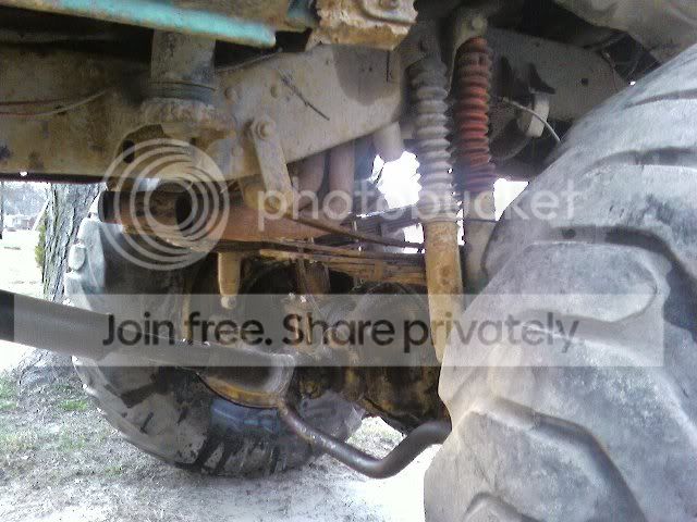

front springs

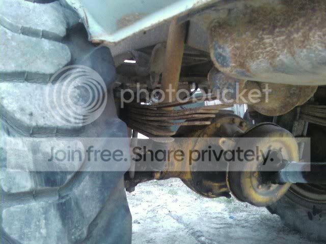

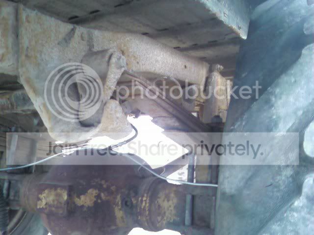

rear springs
Does this thing go in the rocks at all? or just mud? Cause I would be worried about that tie-rod grabbing rocks
well i run mostly mud . . wanna try a rock here or there just cuz i know alot of people that go and would go with the group . . was talking about running telico but dunno .. . . .tires have pretty good tread . . thinking about grooving em just because . . opening em up . . tread is pretty much 3/4 deep on all but one tire . . then the side lugs are pretty deep .. thinking if i run rocks i'd run em backwards but dunno

still don't think it's gonna help much. . . needa get my bars under it . . i mean never did that with 44's and stuff but alot of weight and tire to move . . i figure threw gear reduction putting 53,000 ft-lbs of torque down . . . alot of twisting on the spring . . . . so defently gotta get my bars under it but thanks for the suggestion
oops miss read something . . the tierod . . well had an issue the axle rotated the wrong way (set up for rear engine) so flipped em upside down . . now the tie-rod is going above the pinion . . if it worked the other way i was gonna change it anyhow . .
:bow:Thats a sick rig you got there, is it safe on that trailer
i think once i put my heavier tires on the trailer and cut the fenders a little it ll be fine . . . . the trailer is built to the hilt other then the axles are a little small . . it has 6 inch I beams running down it and 3 inch I beams running accross
am on the look out for about a 40 foot low boy 5th wheel trailer though :bow:
