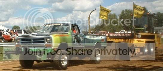

we had a 496 making around 850 horse in my buddy's 81 K30, yes you can run front traction bars, go to TSC or any farm supply place and buy some Category 0 tractor top links......cut in half and sleeve to fit......built many a front and rear traction bar out of those......
here are a few of my friends trucks and other guys we pull with....
ill post some more if you want......
