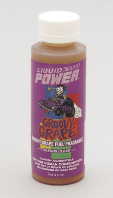

Maby this is what you need :)
Why deal with the nauseous exhaust fumes from your race vehicle, when you could be sniffing root beer, pina colada, or bubble gum instead? Manhattan Oil fuel fragrances eliminate unpleasant exhaust fumes and the eye, nose, and throat irritation that come with them. Just mix them in with your regular fuel--one 4 oz. bottle treats 30 gallons of alcohol or 20 gallons of gas. Plus, they're available in 19 different fragrances.
