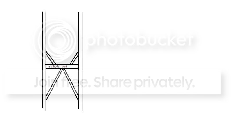

I'm going to tighten down all the bolts for the body mounts first of.
Since my body is kind of weak I'm thinking about this.
Just make an x with the rear body mount. I should strength it a good bit. I dont want to do a roll cage yet and this would be very easy to do.
There are a number of x brace designs out there for other vehicles. Seems like a good idea.
That will help strengthen it up, but in all honesty. You really should consider getting another frame put under that thing. Not trying to beat a dead horse or start a big argument but you know that the frame is cracked and bent. The only true fix is to just replace it. You can probably get another frame for under 100.00. By the time you buy the tubing, plate steel, welding wire or rods and clean that frame up to weld in the braces you could spend half of that or more. Plus you will still have a stiffened, cracked and bent frame. It isn't very hard to change out either. Anyway, just my opinion.
JEBSR is right. A memeber has post in the general parts forum right now with a few frames for sale for around that price.I think they are located in NE texas. Might be worth your while to take a look.
I would also go with a replacement frame. Bracing a frame that is cracked and bent is just putting a band-aid on broken foot. Yea, you might be able to walk for a while just fine, but the real problem will not have been addressed.
X3 on a new frame. my truck is trail only and I have considered swapping frames since it easier then continually fixing mine.
