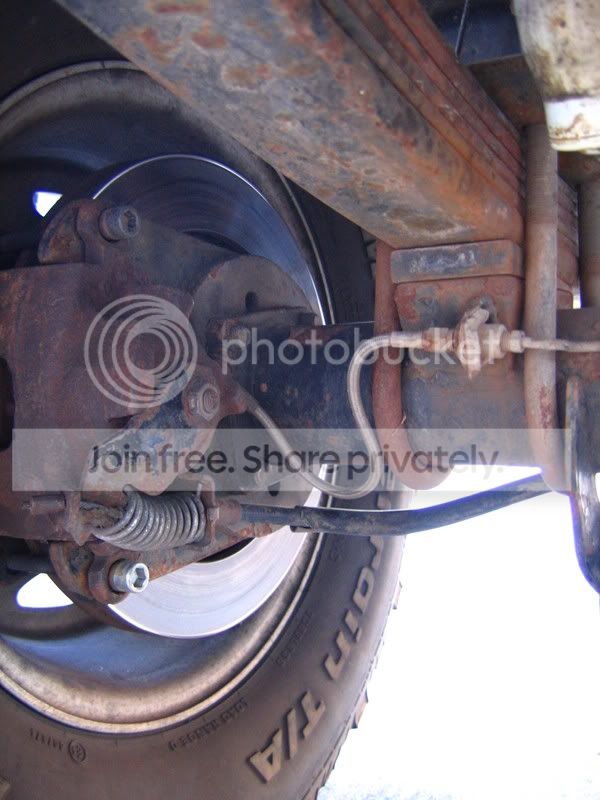

Yours look like this? I have TSM kit but I do not know if the previous owner did anything different from the original kit. I think I might have TSM parts booklet laying around.
They do look just like that. I think I have the catalog in the box they calipers came in.
Of course they are sold by TSM but I didn't order them when I purchased the calipers.
On a side note, after looking at yours I'm for sure gonna paint them.
If the banjo bolts are 7/16"-20 it is a TSM 3701,
If the banjo bolts are 10mm x 1.5 it is a TSM 3700.
These are rubber lines that are 9 1/2" long and for a 3/8"-24 hard line on the other end.
