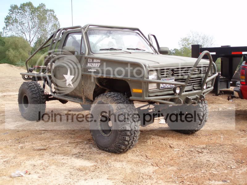

Hey guys I havn't been on CK5 in a long time so I figured I say whats up. I made it to the top 50 and would really appreciate the votes if you think my truck is worthy. I'm #38 and my buddy is #4. Some of the info on the was forgotten or changed, so I figured I give you the specs.
It's an 87 M-1028 "K-30"
6.2 Diesel w/GM 8 turbo
th 400
Klune 2.7 to twin sticked 205
High angle shafts
14b 5.13 detroit
D60 5.13 detroit Yukon cromos and super joints
High stear Hydro assist w/PSC double ended ram
52" front springs
Haven't decided on the rear
If you guys wanna know anymore let me know.
Thanks

Well that sounds like a great set-up.tires, wheels, cage?.....Good luck:bow:
42" rocks on 15X12 eaton locks, full exo w/tube flat bed, it dosn't have doors anymore.

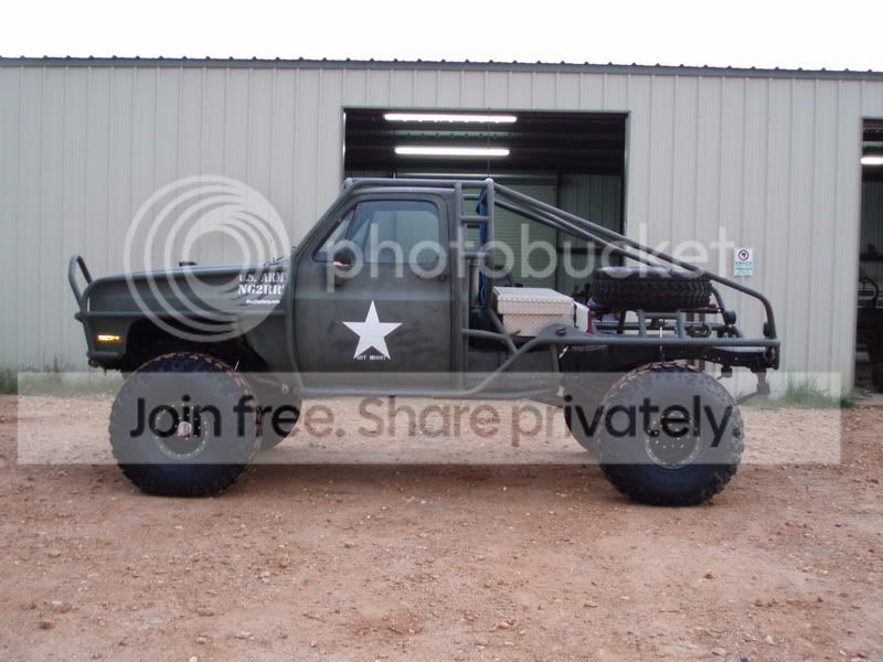

Heres some pics

Nice truck. I dig the exo. I'll vote for ya if I still have time to send in my votes... I have been lazy. Honestly, I wasn't going to vote for your truck originally, but now that ive seen more pics, I like it. Thats what sux; there arn't enough pics/specs in the mags to make a good decision. You're gonna have to do something about that air intake though if you get voted in.

ps. I love the exo that turns into your rear bed. Melds into one another really well.
