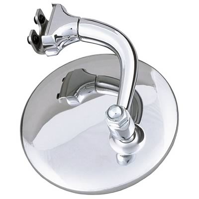

these work suprisingly well. can attach on drip rail or on the door frame.
http://www.summitracing.com/parts/TRD-6652/?rtype=10
Here is the pic, I think they are a little pricey, but you should be able to come up with something similar.
