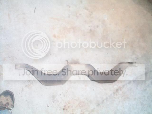

The knuckle, right where the u-joint connects the two yokes on the top of the shaft. It is actually sitting right on the crossmember. I have some other crossmembers at home that may work, but I wanted to see what one for the 400 was supposed to look like if someone happened to have a picture handy.
i bet you mean the cv joint. i think the crossmemeber you need is the W shaped one. it's higher in the center so you can take out the homemede mount.
Yeah you need the other X-member.It looks like somebody has made a spacer between the adapter and X-member.I have one if your interested.
Not mine,but here's what they look like.
No, looks to me like he HAS the short adapter, instead of replacing the crossmember, they made an adapter to bridge the difference between the short and tall adapter/crossmeber.
Half a dozen one way, six the other I guess. Would certainly have been smarter/easier to just get the crossmember the tranny/t-case came from.
"W" or "Single Hump" crossmember will likely solve your issue with the driveshaft. But cause one with the exhaust.
Thanks. Exhaust isn't an issue since it is being sh*tcanned soon for a new setup. It is getting a little weak in spots and they also brought the tips right out in front of the rear wheels. I had to cut the ends off since they interefered with the rear 4" lift springs when I put them in.
If you are playing around under the truck, any chance you can measure the distance from bottom of frame rail to the bottom of that crossmember? (just a 2x4 across the bottom then the gap measured to the frame rail would be accurate enough)
It seems like the later crossmembers/t-cases hang down a lot more, but I can't figure out why. They match the t-case, in your picture, you can clearly see that. The single hump crossmember alone will provide frontal protection for your t-case, whereas now the t-case is nothing but a rock catcher.
