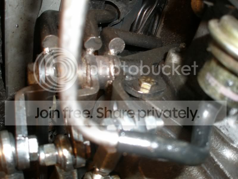

After looking at pics from other folks I have successfully hooked up the 205 linkage to the outer shifter. My problem now is the OE lever on the 203 - If installed with the lower offset outward it hits the 205 linkage. If I flip it over with the lower offset towards the 203 the lever itself bottoms out against the case and binds.
Here is a pic of my lever (I think this was from a '79 400/203) -
I noticed that my lever has a lot more offset than the 4th pic down in this post -
http://coloradok5.com/forums/showpost.php?p=2506704&postcount=9
Is that lever an ORD part? Am I missing something/parts?

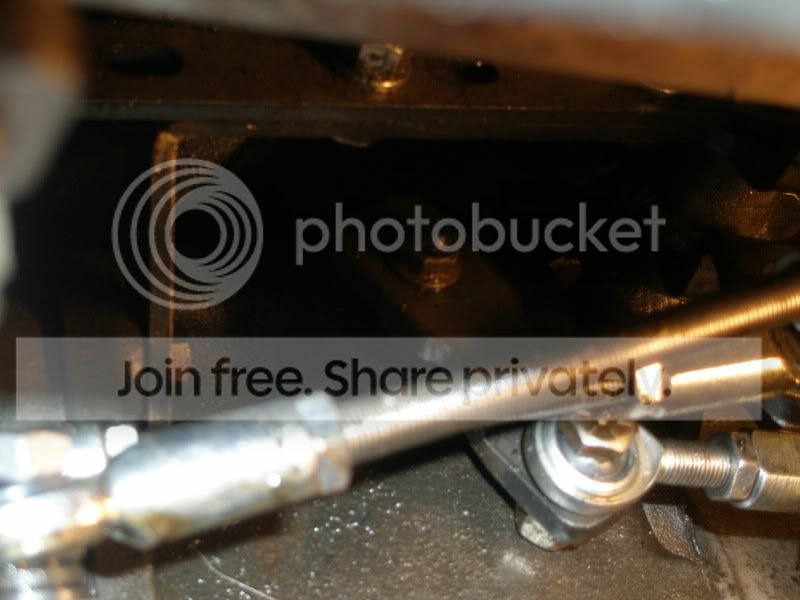

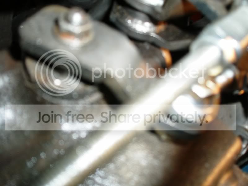

The new arm came with the ORD triple stick shifter kit. Here are a couple of pics.
Seems like you could remove some of the bend out of your shifter and make it work. Were you planning to have the 203 shifter completely separate? Here you can see how the levers are connected..203 is on right.
I've figured out my problem is I'm missing the 203 lever from the twin stick kit. I'm going to call them tomorrow and get one.
