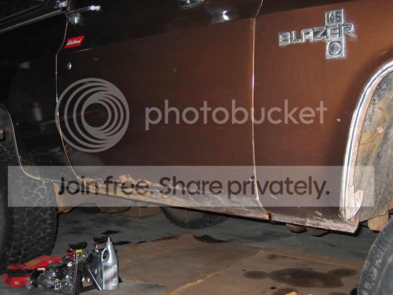

As far as 35's clearing with a 4" lift???? I rub all the time with 4" lift and 33's (I do wheel very hard though) and it only rubs on the back of the front fender.

It dosent rub much and not all the time but with 35's i imagine it would be much worse. Again this is with 4" lift and 33/12.50/15's. this is also an old pic, I have since replaced the rockers and destroyed this door with an oak tree.
