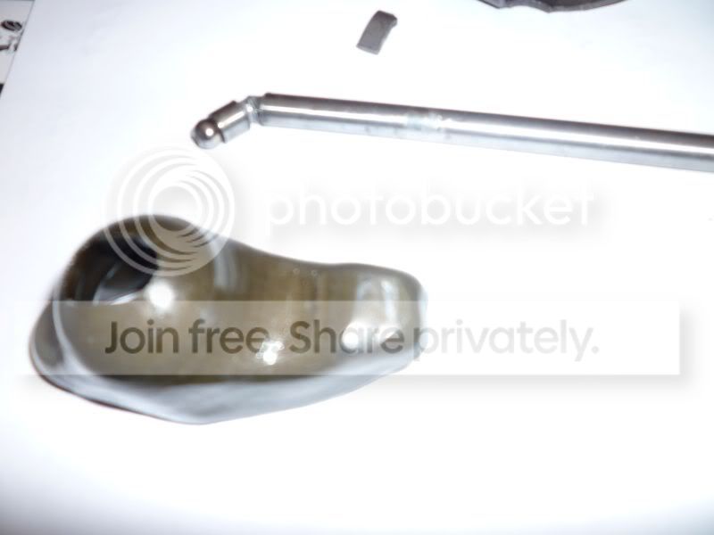

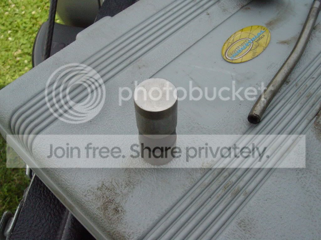

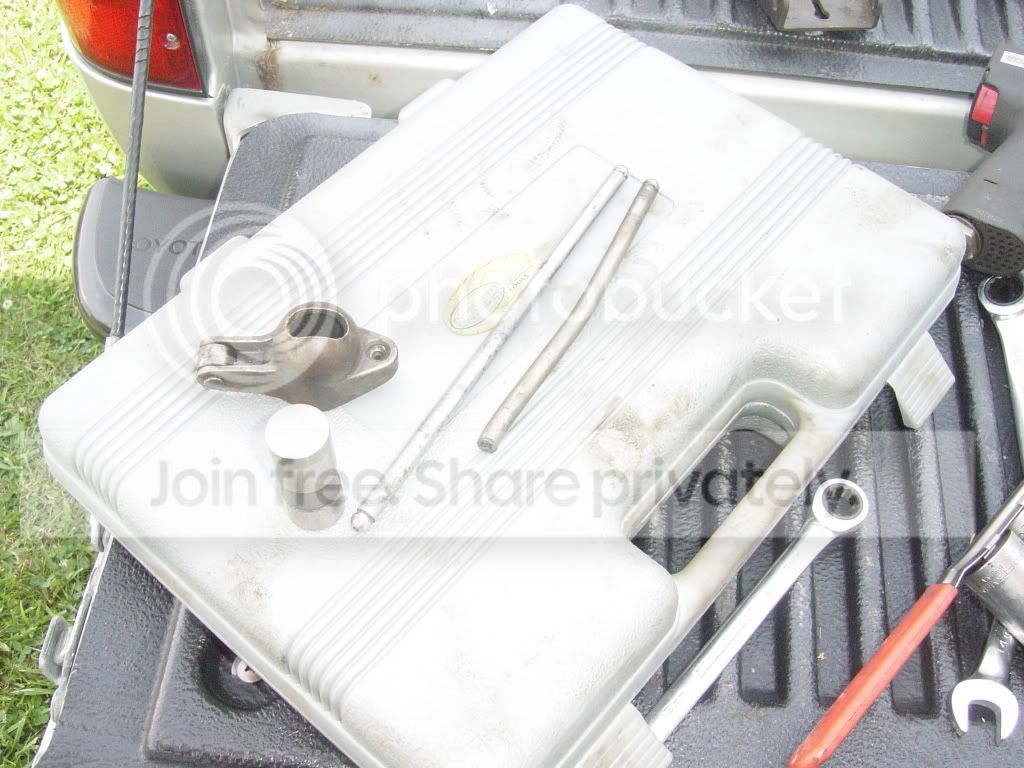

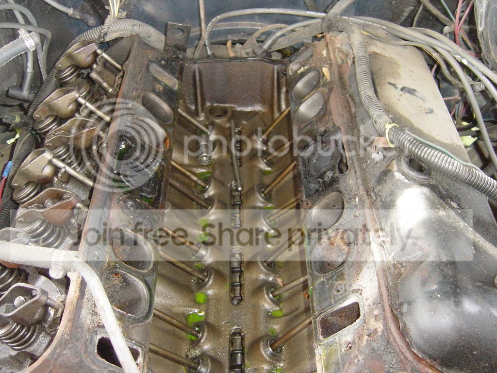

I pulled the intake on my newly aquired C20 Sub's 454 and found a bent/broken pushrod. The lifter base looks fine. No apparent damage to the cam lobe. I'm missing a couple of inches of push rod though(no idea where it may be). I've got a call in to the PO to see if he removed the missing piece.
When I got this thing the PO had started the teardown already(most of the intake bolts already removed, distributor still bolted down, maybe the PO pulled the rest of the pushrod out of the head?) Any ideas on what may have caused this?

I'll give it a try. The rockers on it are the 1.72's. Didn't think to check the guide plate for damage. Still waiting on the PO to return my call about the missing piece-o-pushrod.

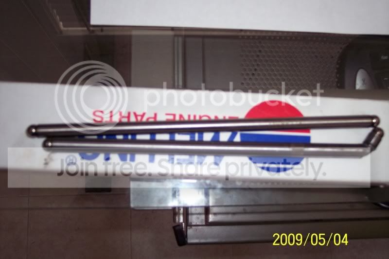

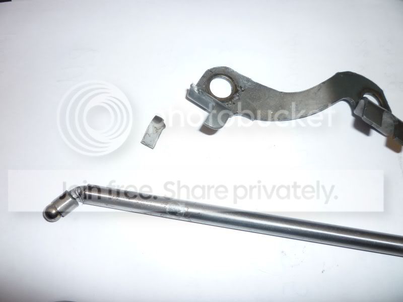

Here is a couple pics of mine. It looked like on mine the guide plate was bent in so it rubbed against the push rod. Wearing it thin till it failed and broke the guide plate.
