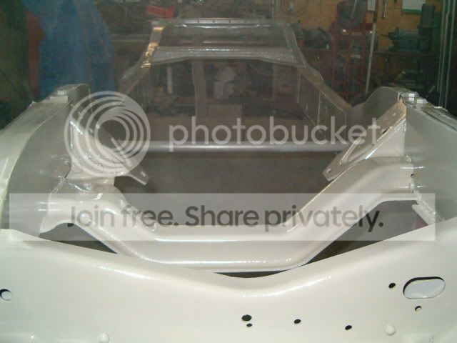

I'm in the middle of doing a frame - off on my 90 model right now and want to make sure that I do everything right the first time. I'm cleaning up the underside of the body and it's in great shape - no rust at all. The only areas that really "need" attention are where I've welded in panels to repair the cracked floorboards under the front seats. I'm going to use some seam sealer their.
What do you guys recommend for painting rest of the body? I've used Summit Racing's "Chassis Shield" paint on the frame and axles and it seems to be a pretty durable coating. I've thought about using it on the body as well, but there may be something better.
Any suggestions are appreciated!
