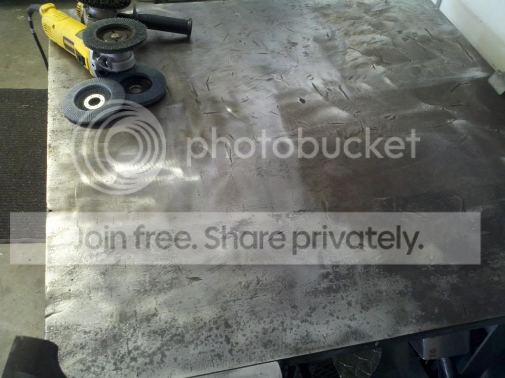

Here's a pic of our welding table after a few passes with the paint stripper.
Hmm. I think I'll have to pick up a few. Stripping paint with a DA sander gets old quick.
Correct, the sandpaper will "load" with paint and smooth out your paper so nothing is really happening. They call the paint strippers non-loading, non woven so the paint can escape or exhaust from the disc. The non-woven part means it will be nice to the metal and not heat or grind it away.

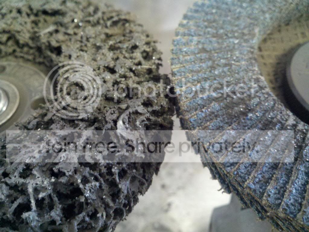

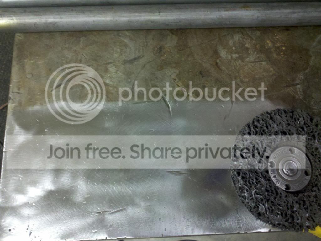

More Progress Photos!

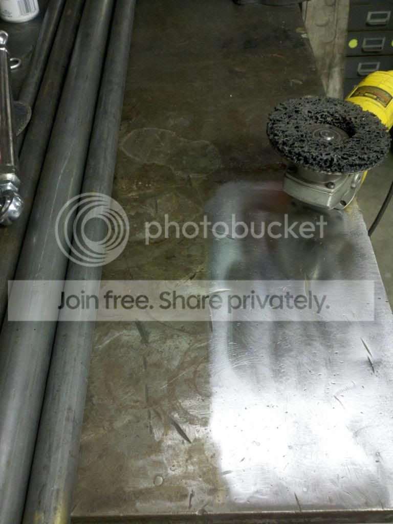

Here's a couple more pics from the welding table clean-up. Some of these rust spots took a lot of pressure to bring the surface back to life.
I was trading up with the flap disc in certain areas but it would work good and then load up. The paint stripper disc did load a little bit but stripped the most volume in the shortest time

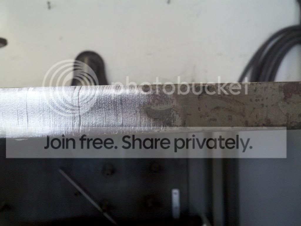

Here a profile of the table edge caked with some paint. You could feel the chips hitting my feet along with some of the disc material!

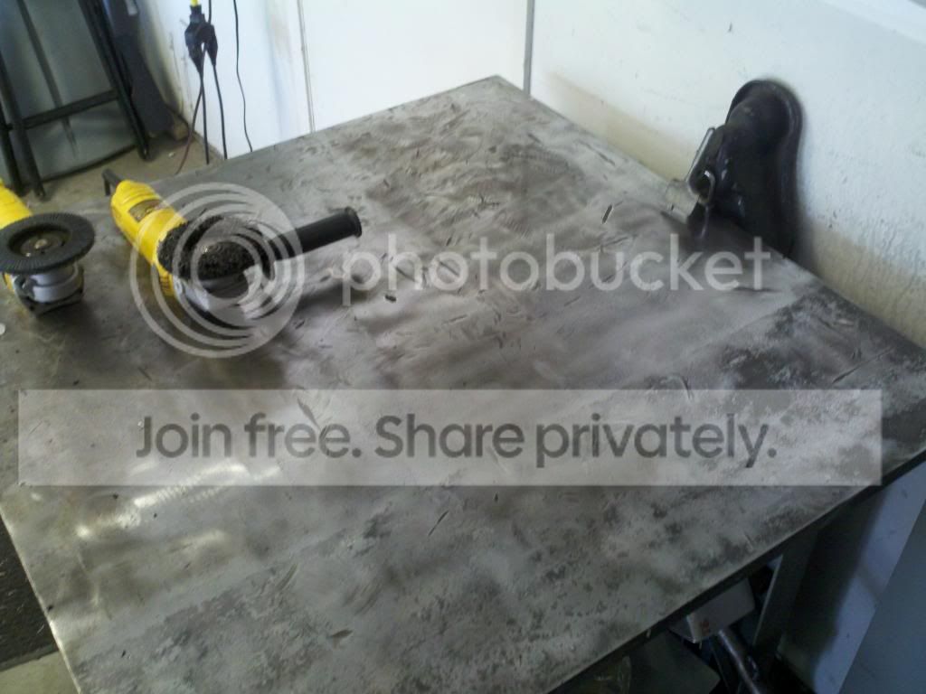

This was after about 20 min of grinder time. Getting closer but that rust in the far right corner is tough.
