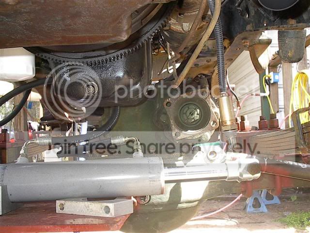

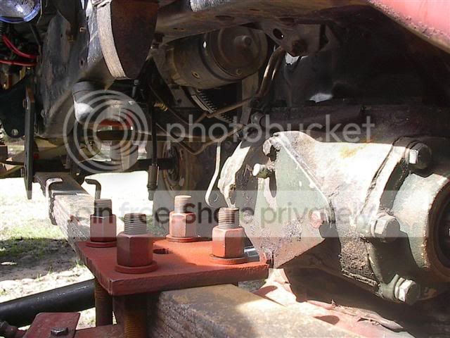

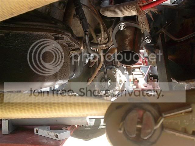

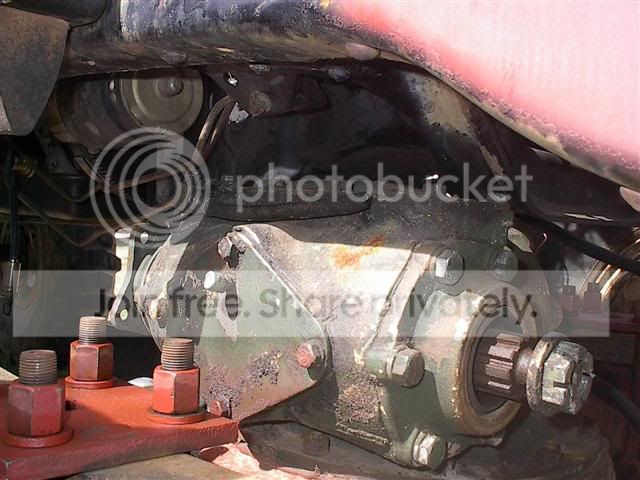

Is uptravel needed in the front suspension? I see jeep all the time on 44's with no up travel at all and they do great. I decided I may redo my front suspension and go with my original idea of moving the stock rear 56's to the front and run them. I put them in today and the truck is now 6"s lower but the crossmember under the motor is sitting on top of the diff. I also need more clearence under the spings between the spring and the steering cylinder. Not sure if this is a good idea or not but what i am thinking about is building some front spring perches that are angled to get my right pinion angle and be about 3" tall or so. They would be welded to the axle and gusseted so they will be really strong and it wouldnt really be the same thing as running blocks in the front. I already plan on having a traction bar on the front to control axle wrap so that wont be a problem. The only thing that I am wandering is if having no uptravel will be a problem. The truck is gonna be for rock crawling and trail riding. Right now the way it is sitting just turned out a little bigger then I was hoping.

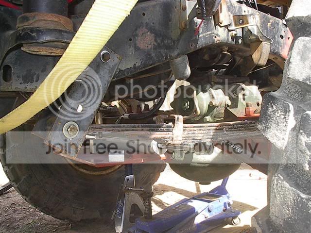

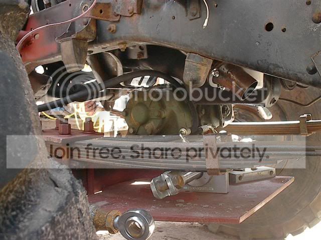

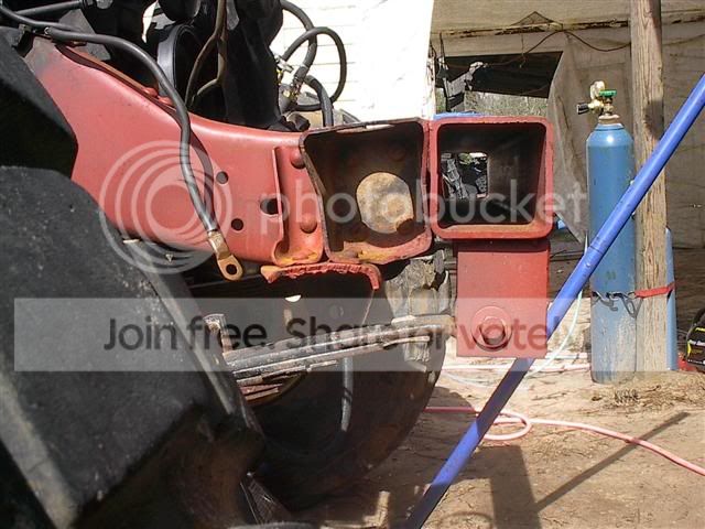

This is how I did the 56" springs on the front. I already have 7" shackles and moved the front hanger about 4" forward from the stock location.

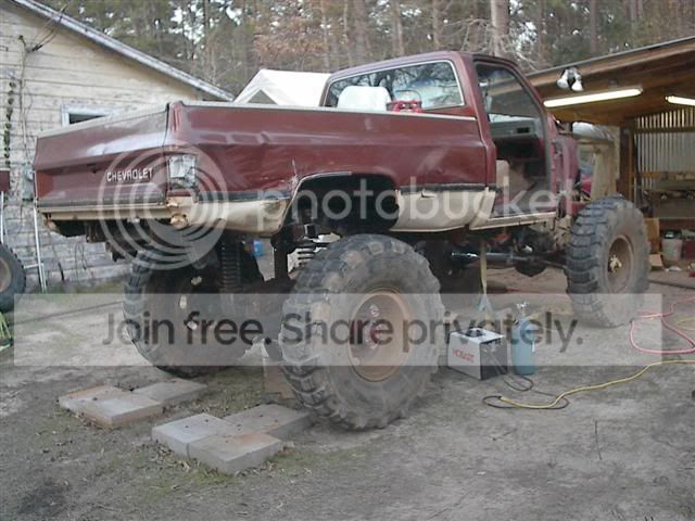

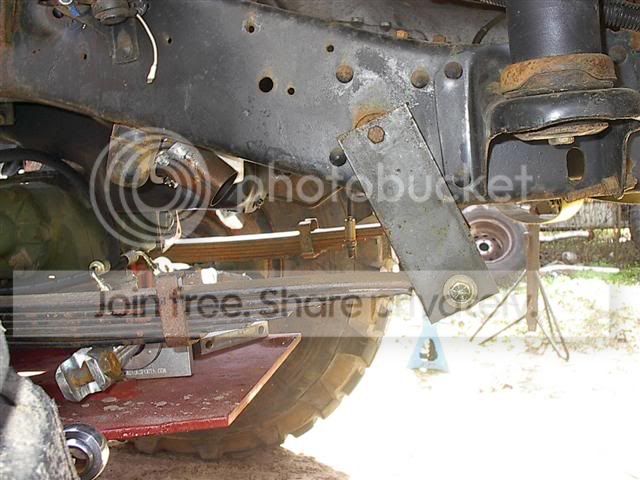

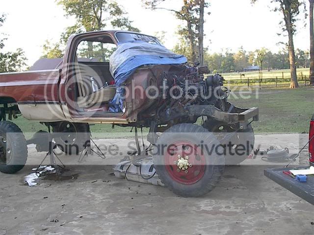

This is how it is sitting now. It has 56" long 5" lift springs from the rear of a suburban I believe it was. The reason why I picked them is because they have a spring rate of 420 which was the softest springs I could find. I removed the overloaded and the bottom leaf springs and that lower it about 2"-3"s.
Cut the overload down makes a zero rate thing kind of, if your build the perches up to a point they should be fine. But if your diff is hitting the cross member now 3" isn't going to do any good. Is it a factory cross member can you redo it ?
When you drive off a ledge and the front slams down the front end moves alot. The ORD crossmember for example is alot futher under the oil pan then the factory one.
The "welded block" that you're planning on making will make axle wrap worse. If you add a traction bar it will have significantly more leverage applied to it (i.e. it will need to be stronger, joints will wear out quicker, etc.).

Uptravel is not necessary for anything other than desert type racing (i.e. jumping). Your truck looks like it has an awful high COG for the the rocks IMO.

I do plan on doing that and that will give me 1". Which with the superlift 5" springs I had in there with that 1" it would be cleared the steering good because the springs had a good arch to them. Well with the springs they are a lot flatter so I will need about 2-3" just for safe measure. Plus like I said I need some more room above the diff.
It is still the stock crossmember under the motor. I am actually thinking about maybe rasining the motor about 2-3"s since I have a body lift and rebuild the crossmember under the motor. Also that will make it easier to run the exhaust since right now I am just about out of room under there.

And finally yes the truck the way it is sitting now will have a high COG for rocks so that is why I am wanting to change it. It will be a while before I get to some real serious rocks where it would really be a problem but if figure I might as well go ahead and change it now.

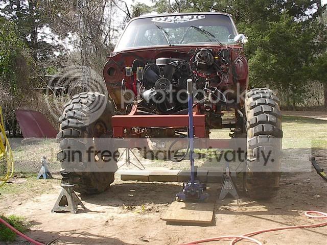

I went out and looked at it a little more this morning and I think that I can make it work. I am gonna raise the motor about 3" which I should have plenty of room to do since I have a 3" body lift. Then I can rebuild the crossmember under the motor to where it is flat across the bottom of the frame or really close to it. I know that raising the motor will make the COG higher but this is the only I see to get the truck sitting low like I originally wanted and get some up travel. By the time I get done I am thinking I should have about 5-6"s of up travel on the passenger side and even more on the driver.

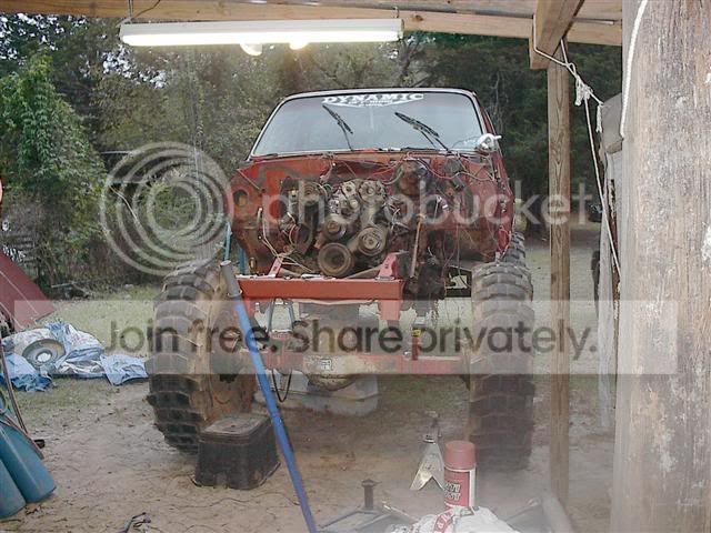

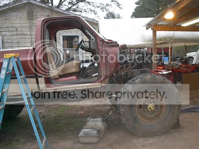

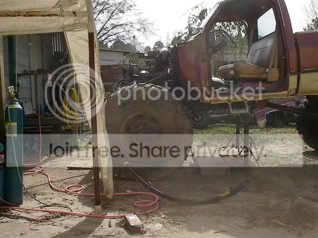

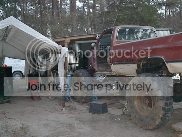

This is how it sits with the 5" lift 56" rear springs.
This is where it is sitting now with the stock rear 56" springs moved the front.
