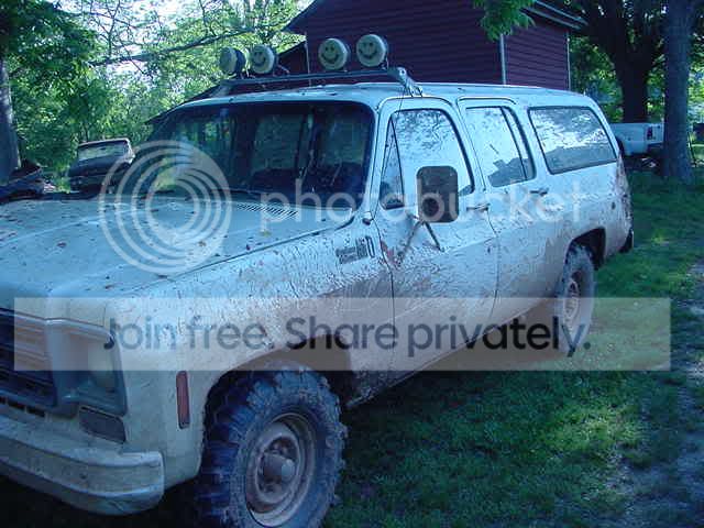

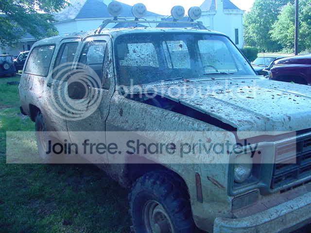

Here are a few pics of the turd

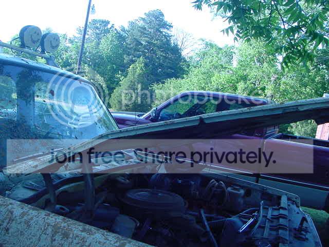

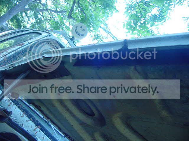

I had welded a strip of angle iron inside the hood to remedy the kink, now the hood has decided to kink behind that angle iron.
