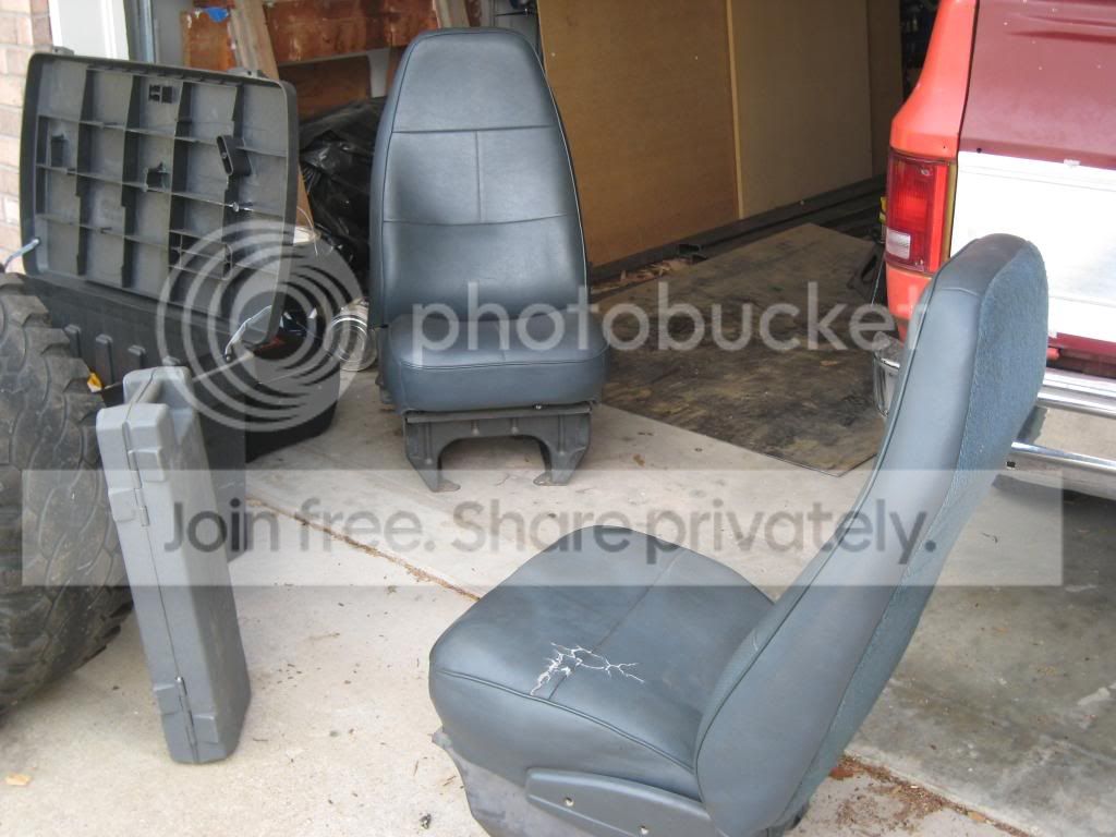

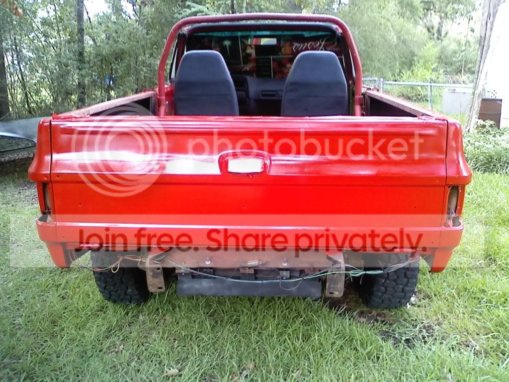

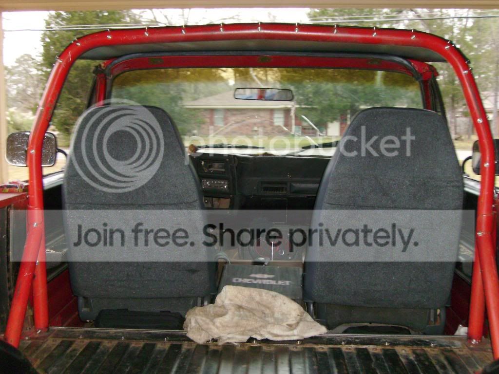

My main concern is how to mount them. Front buckets in the truck right now are from a Ford(:doah:) fullsize van that my dad picked up years ago. I have a rollbar (no clue if it's factory or whatever). Let me find some pics to better illustrate (Below). Some are old, but give you an idea of what I've got right now.
I have read that harnesses have to be mounted at a certain angle to properly restrain passengers, and need to know how I might go about mounting these, whether to the rollbar, or to some modification/addition. I will have a backseat in the truck, and would also like to keep some semblance of access to the rear seating (the non-tilt-forward seats already make it tough...:doah:).

Here's a couple pics of my setup to give you some ideas. The most important thing for me was to get my seats off the floor and mounted to something sturdy. I figured seatbelts wouldn't do much after my seats ripped through the cheesy metal floors the previous owner replaced the rusted floor with.

I knew someone on here had installed them, but couldn't remember who. And after reading I am still worried, b/c both you and 5280k5 have full cages...something I don't want to get into yet. Also you said something about 45degree angles and how far back corbeau wants them mounted....hmmmm...

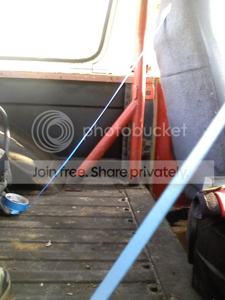

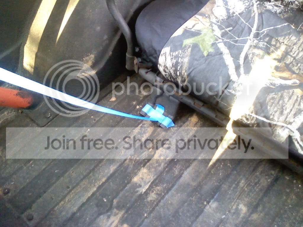

Found it They put them in ricers and use the rear seat belt mounting point. They just don't want them dropped to the floor right behind the seat. The further back the less of an angle.

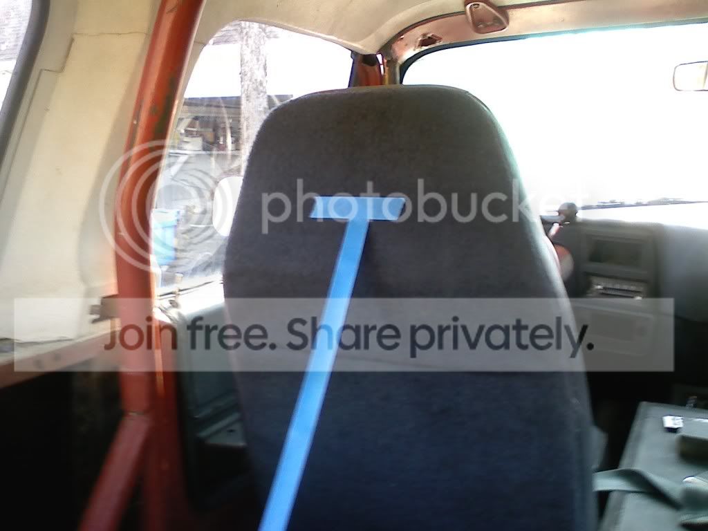

Sweet, thanks! Went out and did some mockup with tape. Think this would work if I put some slots in the seat back? Or is the angle too steep?
does that seat have a slot in it?
I WAS gonna do the corbeau retractables, but was concerned with how they would slide thru, and wear the slot in my PRP's... not to mention my cage bar is RIGHT behind the slot/seat... the retractothingamabob prolly wouldn't fit...

Nope no seat slot. was gonna either put some in or have a local shop do it. If I had the coin I would pony up for new seats from PRP or Corbeau, but nothing doing, no way I can when it'll easily be $600 for a pair of buckets. It's just looking like there won't be an easy bolt up answer...haha, as if anything thus far with this truck has been...:haha::doah:
