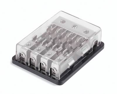

and add something like this
Does that sound ok..
