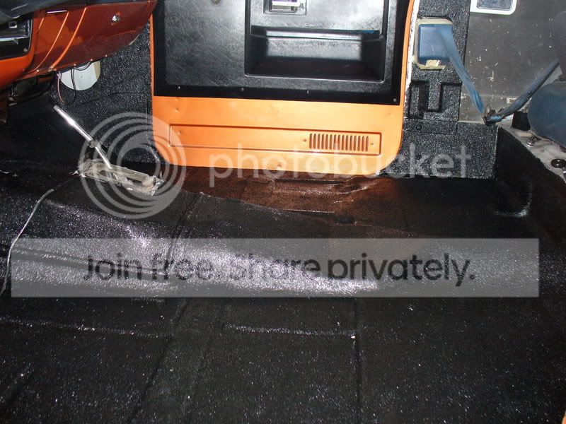

I've just done my side panells. Made them out of sheet metal. They look pretty good. I'm thinking about redoing my seats pretty soon.
In pic #2 you can just see the 12V aimable light pokin out of the 12v receptacle that I stuck in the B-pillars. One on each side for the kids use in the back seat.
Aluminum door panel lowers. Wire brushed, no polishin' hear. Seats are aftermarket, Every panel has a sound deadener behind it as well as under the carpet.

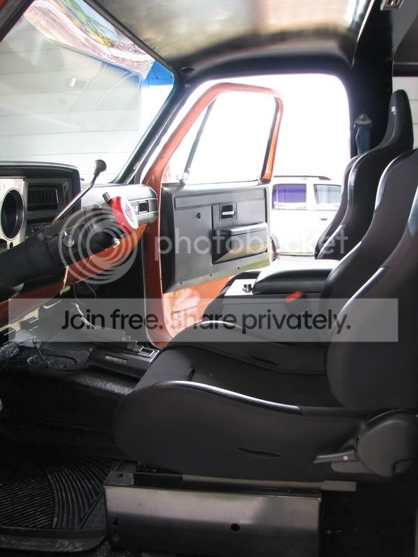

I am currently in the process of putting new seats from a 2003 chev. The seats and center console will fit perfectly. I do need to drill 3 new holes for each seat though. Price for the new seats was real good at $250 for all. Good luck! I will try to post some pics of the rig when I'm done. I noticed that they do sit slightly lower than the originals.

Seats and console installed:
Nice lookin' seats! Did you fab the seat boxes or is that a kit? I'd love to build some seat boxes with locking compartments that distribute the seat weight a little better...my floor has been punched thru :mad:. Also is that a Tuffy console?
Its a Tuffy console, the seat brackets are from a 90s Dodge van. Bolted right up to the seat but I had to drill all new holes in the floorpan.
Seats from Seatco, Linex'd from tailgate to firewall. Tuffy console in center, contains my ham radio. GPS mounted to the daash. Front of console has toggles for 4 top mounted KC's, 2 side mounted KCs, 1 rear PIAA, 5 rock lights underneath, 2 fogs and 2 front mounted driving.
Under the front seat is a halon fire extinguisher system. Going to put another one in the engine compartment when I have some time.
2 cameras mounted, one in the passenger side mirror, which can be viewed on the LCD screen mounted on the dash. The other is a rear view and shows up in the rear view mirror's LCD.
Speaker pods mount to the bottom of the doors.
Guess that's about it for the interior front. In the bed, the deck bolts to the cage and locks with separate compartments underneath for security. I store too much stuff under there.
