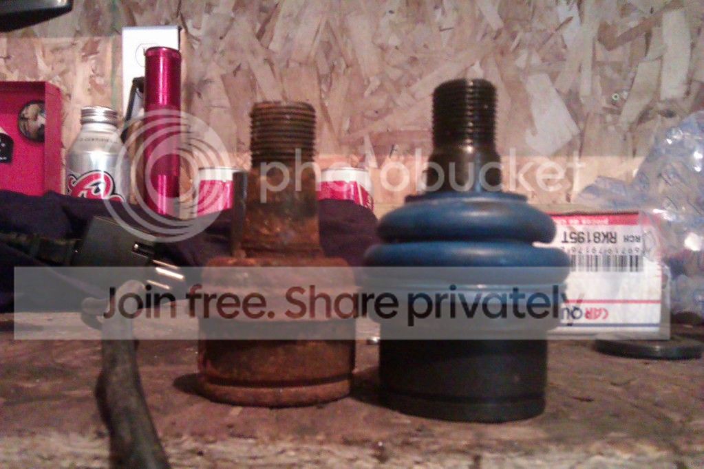

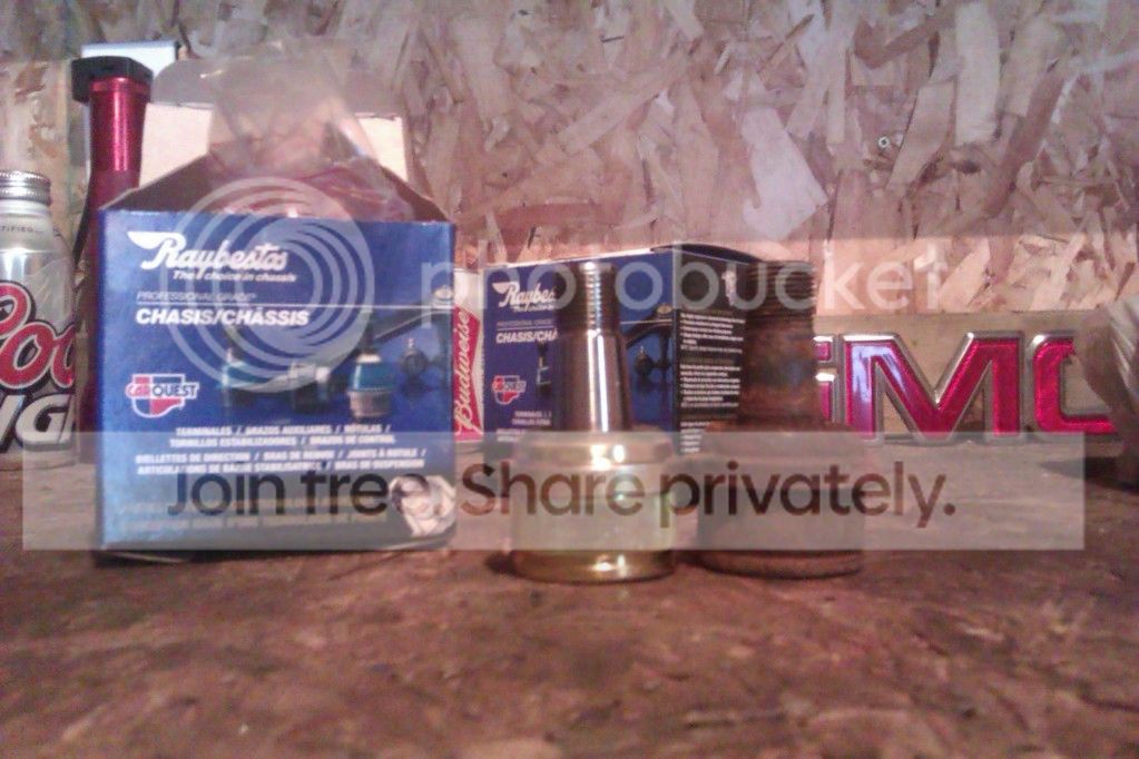

I had the same problem when using cheap brand of balljoint, after comparing to the original balljoints you can easily see the difference. Ended up taking them back and got some raybesto premium brand which are reboxed spicer pieces and had no further problems with the top adjuster.
