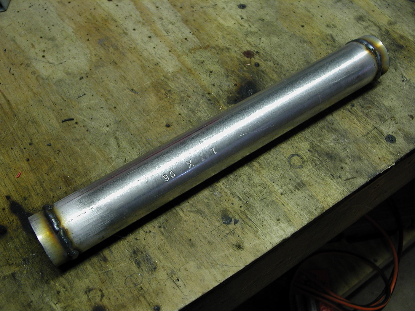

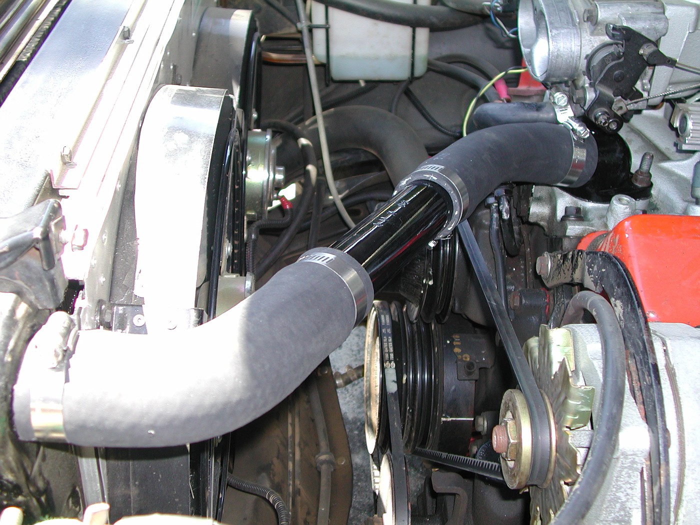

An idea to replace that tube...I got a scrap piece of 1"3/4" aluminized exhaust tubing from my local muffler shop and added a couple beads with my welder.
I did this back in 2004. It's never leaked.
