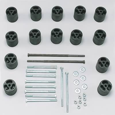

So my truck has a 3in body lift already installed when I bought it. The only problem is that the lift is an old one that is made of 3 1" rubber spacers on top of eachother that resemble hockey pucks. The problem is that they are dried, cracked and some of them have collapsed. I am in the middle of some body work and I would like to replace them before the truck goes to the bodyshop for paint. I ordered an new 3" body lift kit with solid 3" spacers. It looks like this:
http://store.summitracing.com/partdetail.asp?autofilter=1&part=PRA%2DPA%2D513&N=700+4294918515+4294908216+4294925023+4294908183+4294789402+4294906205+115&autoview=sku
So finally my question for you guys is: Do I need to put these on top of the stock bushing which aren't on my truck, or can I just put them metal to metal?
Also If I do need to put them on top of the stock body mount bushings, then where can I get them for real cheap? Also would it be better to use the factory rubber bushings, or aftermarket poly bushings?
you put them on top of the bushings. the replacement rubber is very expensive (at least that is what I found) the polys are cheaper---i found the summit prices are the best. ask for the energy suspension ones---the first ones that pop up are teh expensive ones.
the prothanes are more expensive--look for the energy suspension ones--same thing-better price. i think i paid $35

Ok so today I have been working on replacing the body mounts. I was surprised they all unbolted real easy. So with My new poly bushings I put on the body lift on the radiator support. The problem being that the poly bushings are about 1 1/4 inch tall so with the 3 inch body lift that makes 4 1/4 inches of lift. Thats too much... There was no way I could get the fenders line up with the cab because of nearly 2 in. difference in height. So I have to replace ALL the mounts in order to put the front end back together. :rolleyes:
Well very long story short the poly bushings + the 3" spacers = too much lift for my mechanical clutch to handle. It was bindling way too much to really be opporative. So as of now my body is currently sitting on poly bushings + rusty 1/4 inch metal spacer + 1 hockey puck = 2.5in of body lift and no clutch binding. And it is really bothering me that I have to use hockey pucks on my body mounts. So what am I to do with all this? Anyone know of any 2" body lift kits or have any helpful advice to point me in the right direction?
